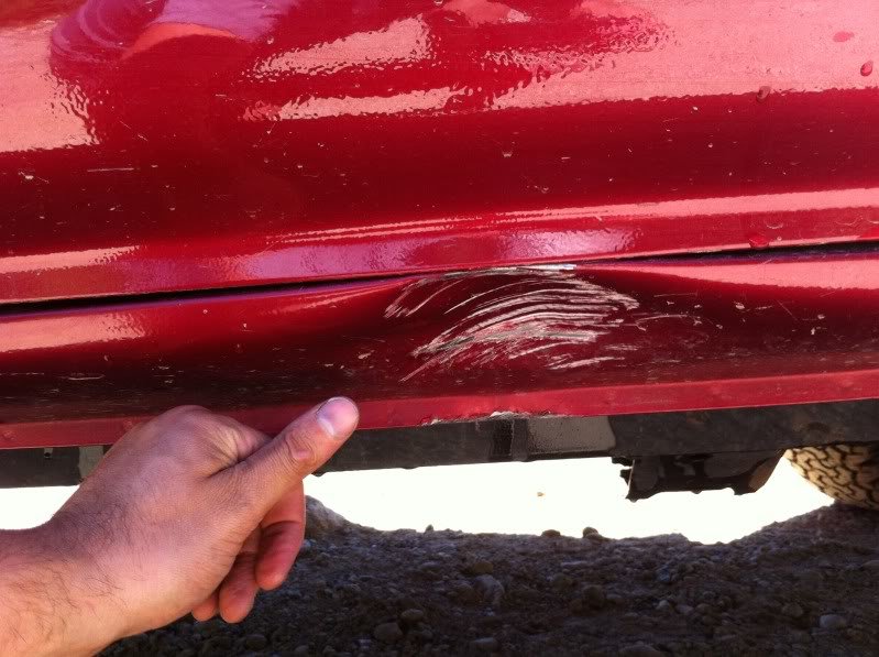

    Would this one qualify for PDR? (and I'm being totally serious, not trying to be a smartass.... just don't know enough about body repair)

    Yup :(
    The irony of it all is I was explaining what sliders are to my daughter about 7 minutes before that shot.

    From what I gather. Rocker panels are more difficult to fix because its a hollow piece and you can't hammer it out from the back. This happened to my '00 taco and they had to weld rivets onto the dent and pull it out the best they could with a slide hammer. Then lots of bondo.

    Unfortunately, no. That dent will not qualify for PDR. PDR is really geared towards hail damage, door dings, etc... Lots of PDR tech's won't touch aluminum hoods, either. In the case of your rocker, it'll have to be replaced, or repaired, with full paint.
