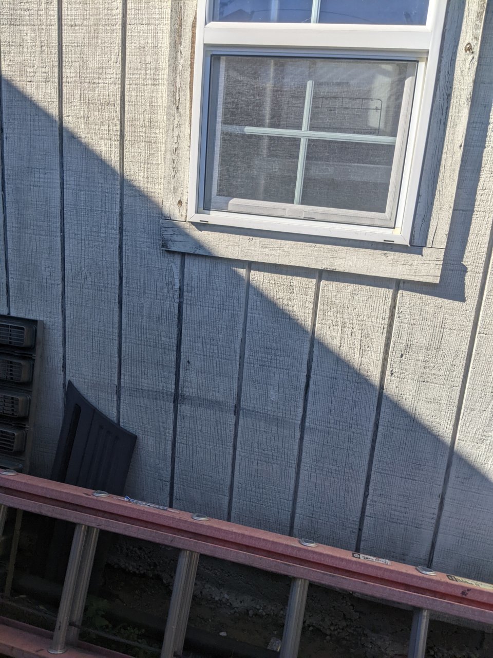

    At a maximum it was three or four days because I was just out there looking at that flare for something else. It seemed to happen on the Jeep almost overnight as well. At first I blamed the gardener and thought he might have hit it with something.

    The flares were in perfect shape prior to this, that means I would have to paint the rest of them too.

    Not enough bandwidth on the internet to list.
    It's abnormal but definitely possible the sun could do that from reflection.
    I have a neighbor that had a window in an unused room that was blocked from the inside. Refractive rays from the sun converged on a wooden fence 5 feet away and lit the bitch on fire and it burned down. :bananadead:

    I inspect homes for a living, and have seen vinyl siding warped big time, from reflective sunlight.
    Having the grill too close, also....

    It was fairly sunny again today and I checked, but it looks like there is zero glare hitting the truck.

    Is there another factor, at times, which could play a part in it? Like another vehicle sometimes parked somewhere nearby which could be he sometimes potential 'source' of the reflection?

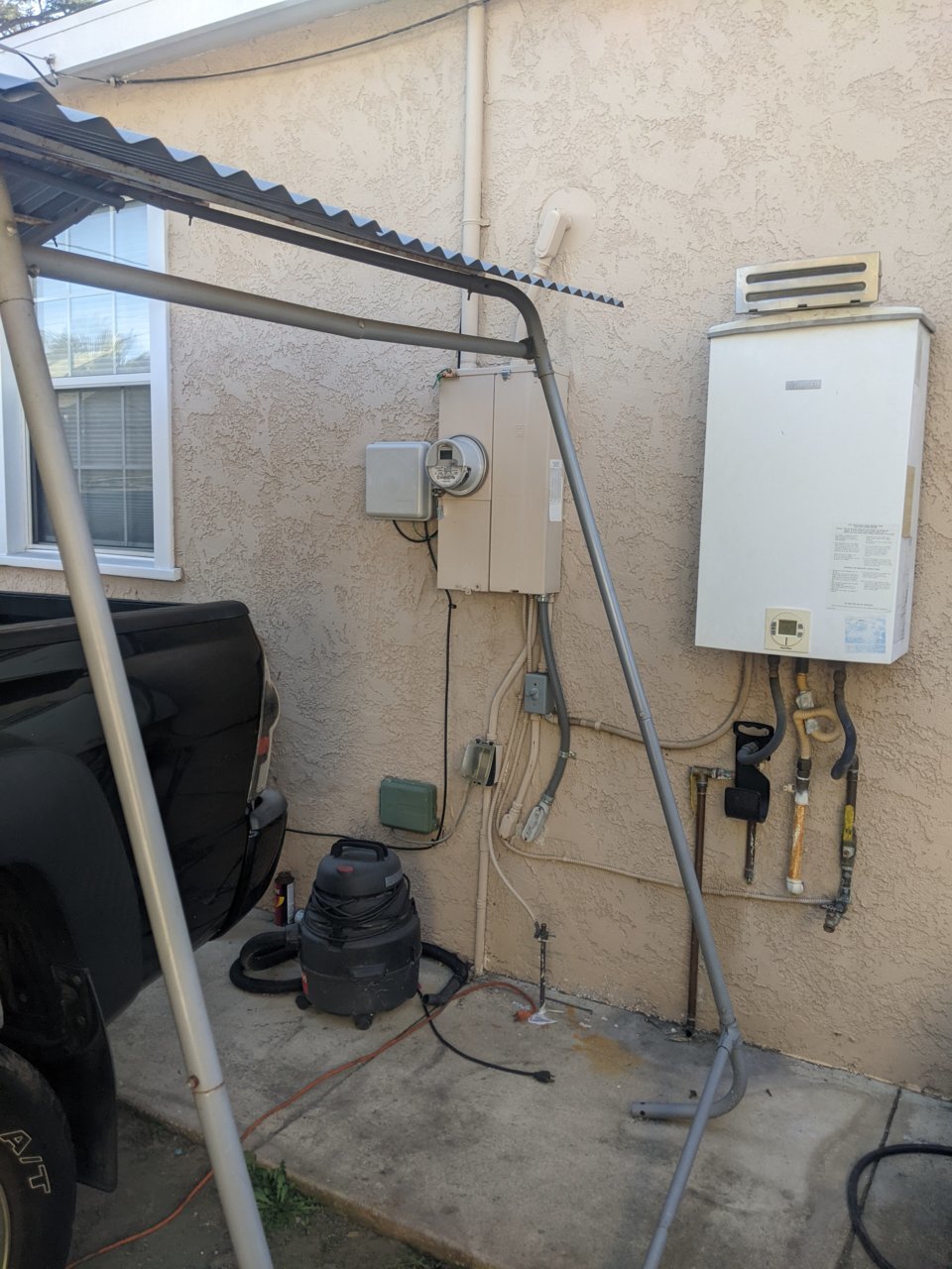

    I figure I would update this for the hive mine to see what's going on. This is the shed and window next to the truck, and where it's parked in relation to the water heater. I was thinking maybe the reflection is coming from the corrugated steel roof of the shed. I also checked the last few days and I don't see any kind of reflection hitting the truck.
