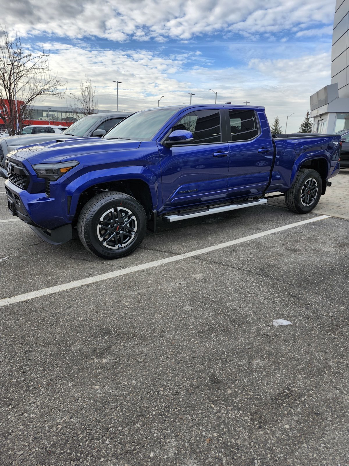

    I've had my 2024 Tacoma Sport for exactly 1 month now. With the inline 4 and single sushi slicer, I do NOT miss the old V6 / 6speed auto of my old 3rd gen at all. The 4 banger has enough power and plenty of torque. I'm still impressed with this truck! 20240207_092338.jpg

    But people here said the turbo engine is a ticking time bomb and will die when you pull it off the dealer lot. Looks like your got her to a parking spot....whew! :p

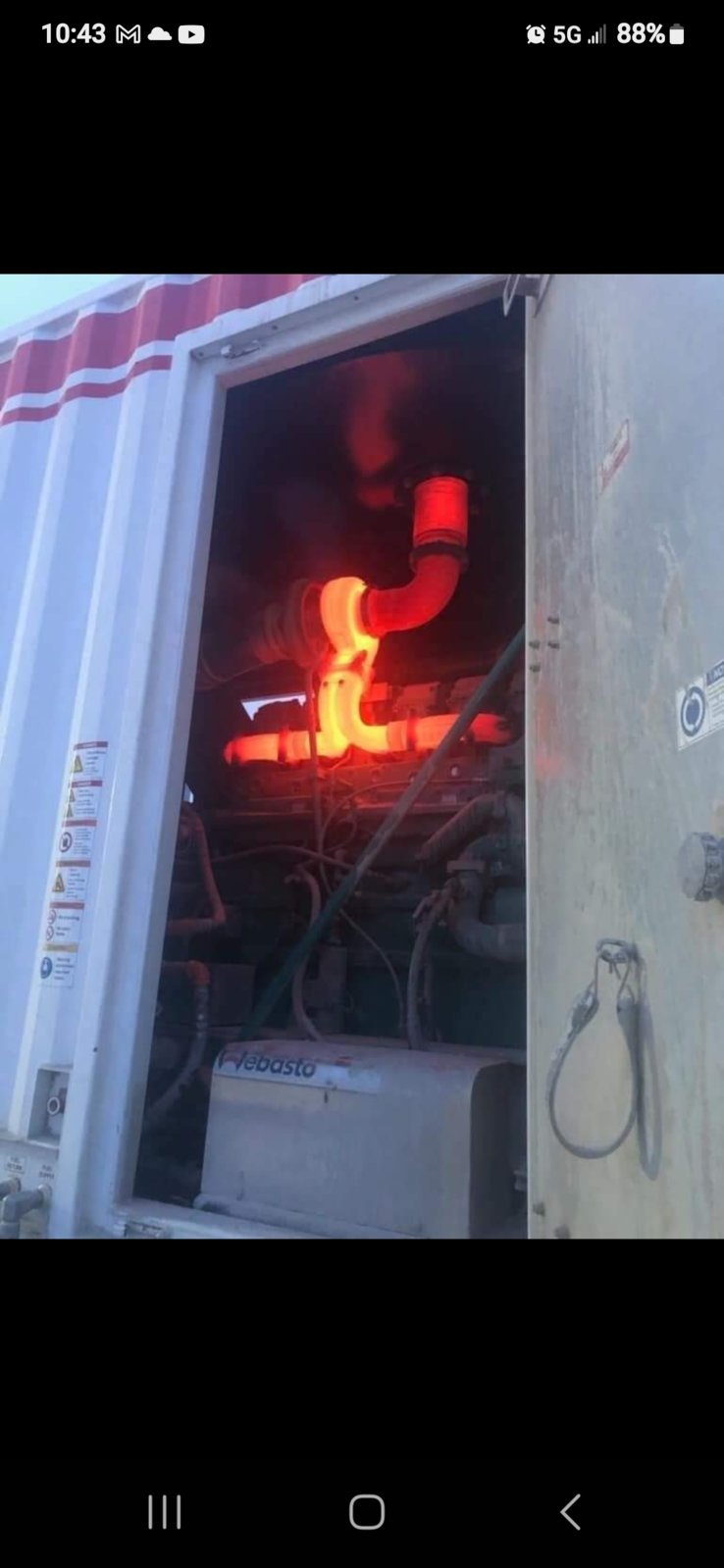

    Ya it was touch and go for a minute.....I also Included a photo of the turbo after I drove it across the parking lot....and forget about snowy, ice covered inclines- lolScreenshot_20240214_224332_Facebook.jpg

    Lol, that doesn't look like it's under warranty! Hey good luck with it and awesome color !

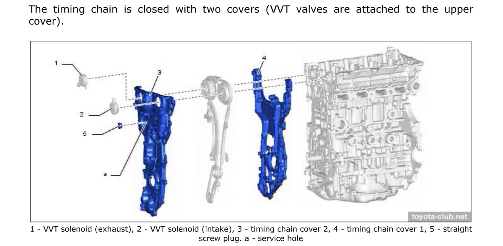

    Every engine Toyota makes has leaked from the cover, its a matter of, how hard is this one to reseal.
    Surprised no one has said it yet...
    T24 tacoma has 2 timing covers.
    BUT
    They are much easier to remove, the cover doesnt require the lower pan to be removed.
    Are you able pull a diagram of the covers up @TnShooter ?
