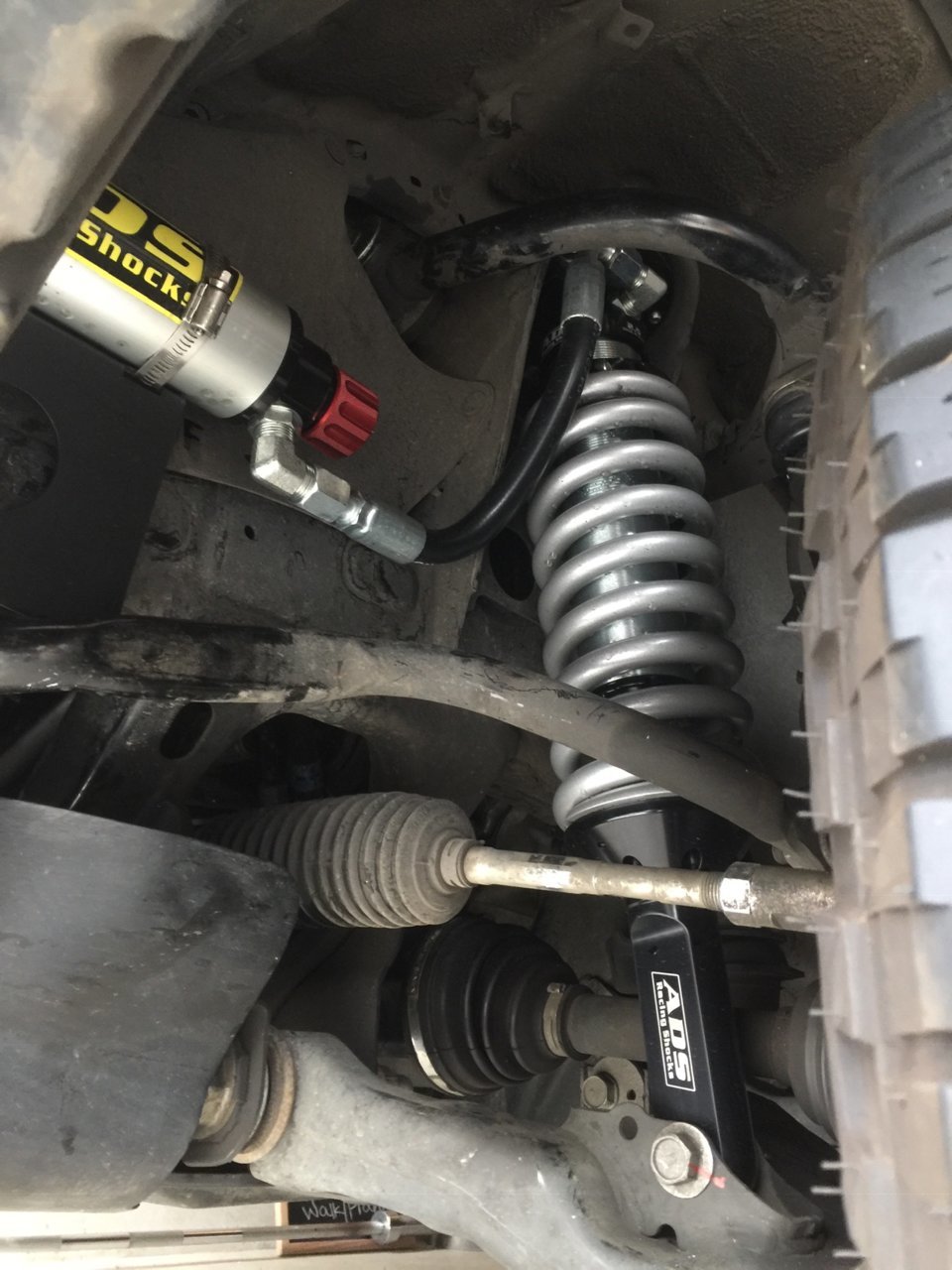

    Look into ADS coilovers. Theyre not mentioned in TW very often for what ever reason....
    Or look into the new Bilstein 8112 coilovers.
    I don’t think it was mentioned but how much lift are you looking for?

    Agree, check out ADS.

    You are forgetting ADS. Their components are better than some of the ones you mentioned and they are valved differently than the others. Progression compression and digressive rebound. American made too
    kbp810, Gunshot-6A and oscolivar1 like this.
  19. Oct 18, 2018 at 1:12 PM
