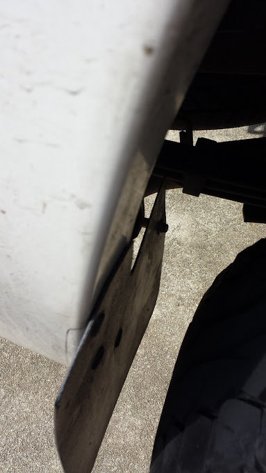

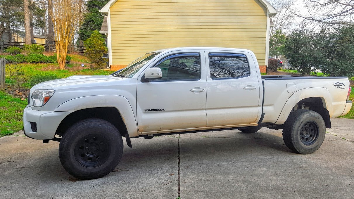

    $30 for the Rally Armor universals. Much shorter and more flexible. Unless its all about aesthetics and you dont like flaps at all.

    Are those the BASICs or the BASICs PLUS?
    Updated: m'eh, ordered the BASICs.

    $24 shipped;
    http://www.amazon.com/Rally-Armor-Universal-mounting-hardware/dp/B00C3AIOTY
    Trace onto cardboard. Cut it out. Tape the cardboard into desired position. Pop holes in it to match mounting points. Secure cardboard to flaps and drill your holes. Mount with the factory pop rivets + 1 stainless bolt/nut and a 1 1/4inch plastic sleeve/extension. Done.
    It seems to me that they literally charge you $70+ for holes and hardware (you can reuse the stock plastic rivets but need to spend $5 at HD/Lowes).

    My pop rivets got thrashed when I took off the fronts so i'll have to think of something to get these mounted. Obviously the stock screws wont work either as they are too short.

    I ended up getting some at Autozone. They're for a Chevy/GM as I recall, but its the same thing.

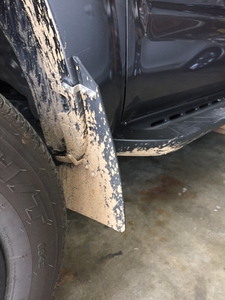

    image.jpg Rokblokz work!

    Was at a friends house the other night and due to other parked cars, I had to drive over a small curb. The resulting CRUNCH scared the shit out of me. I thought I had run something over. It was just that long ass, rigid mud flap hitting the curb.I think I may order some of those universals. Keep the budget minded suggestions flowing, as Im not about to drop 100 bucks on mud flaps.

    Yeah I hear you, luckily I got them during the group buy
