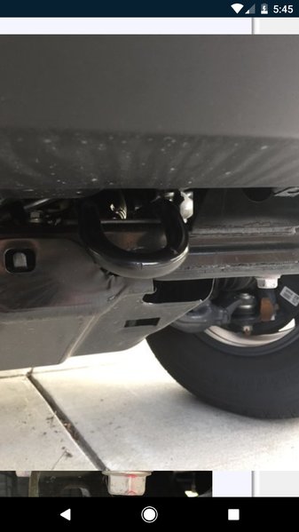

    I'm sure this question has been asked but just wanted to clarify I have a 16' TRD sport.
    I got stuck in some mud last week and had a friend pull me out.. I was sort of in a rush because there were people behind me so I attached the tow strap to the loop that sticks out from the chin spoiler on the driver side. I thought it was a recovery point but later realized in the manual it's just a tie down point when towing..
    I'm just concerned I damaged something. That hook must be able to hold the vehicles weight correct?
    This is the hook I am talking about with the spoiler off

    If it didn't rip off or deform then no damage done.

    You should be good I've pulled people out using that point but I don't recommend it

    You are correct that is just a tiedown. I wouldn't go around getting tugged out by it but in a pinch it works if you're gentle. Look into getting a tow hook from a TRD Off Road. It goes on the passenger frame rail and bolts right on. You can buy it new or watch for someone selling theirs. I just sold mine to another member after I got a front bumper.

    I use mine all the time to pull me out. It's pulled the weight of my truck alone for a few feet a couple times and done fine.

    It's not rated for recovery is the easy answer. It's a small steel loop welded on in two places. The tow hook is a giant hunk of metal that is bolted through the frame that distributes the load better.
    A good comparison would be the difference between the loops on a rear hitch that you connect safety chains to vs. the hitch receiver. Yes, I've seen people attach a tow strap to the safety chain loops but they're not designed for that and eventually will break.

    Owners manual says it is for towing for short distances on a level surface.

    I have an Off Road and I've been pulled out on both front points. Are you saying the starboard hook is stronger than the port loop?

    Yes

    I will usually use a strap to form a bridle between the hook and the loop to share the load. The ARB 10' tree protector strap works well.
