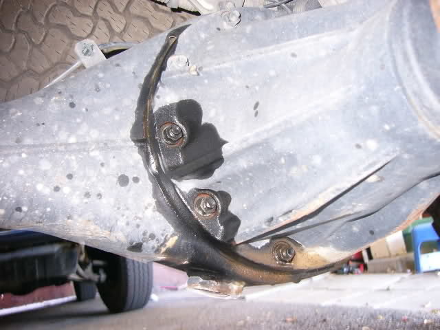

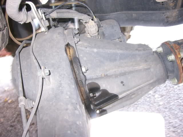

    not really damage in a sense...but a result of being out on the trails just about every weekend...did 2 runs this weekend alone...
    one of my buddies was like dude..your rear diff is leaking..sure enough, every single nut that holds the 3rd member to the axle housing was loose. 3 of them were so loose i could move them with my fingers...took 1 and a quarter quarts to top it back off.

    damn, that aint good! Never heard of the 3rd member bolts loosening like that.

    thats crazy but a lot is going on back there while on the trail...something else to add to the "things to check" list before and after each run.

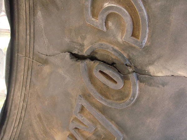

    had to go buy a 35" tire to get off the trail lesson learned have a spare
