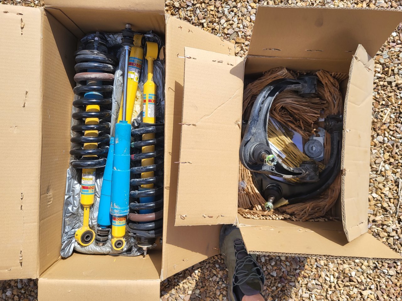

    The front already has a lift, looks like enough to level it out with the rear but just a spacer lift. I am considering a rear leaf pack given what I have read, just trying to decide which one. Theres a lot of options out there. Also, got a full OEM 3rg gen set for $100 lightly used from someone local. Put the rears on last night.
