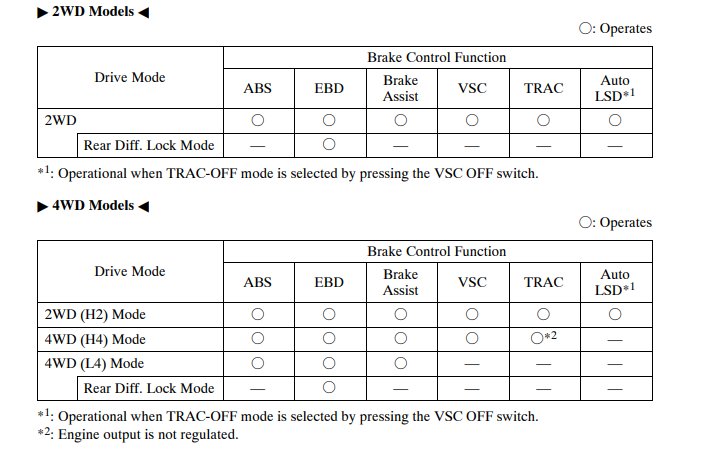

    Tacoma TRD double cab 4x4, Barcelona Red
    Actually the 2009 has LSD front and rear and when you go into 4wdh you automatically have limited slip front and rear. Not in 4wd low though.

    2014 DC OR 6spd 4x4
    Predator tube steps, Ranch Hand grill guard, Magnaflow CatBack exhaust, Toyota tool box & bed mat, 2LO Module by @Up2NoGood, Rearview Compass/Temp Mirror, Tune by @JustDSM.
    Actually Auto LSD only works in 2wd, 09+ TRD OffRoad models get A-Trac which is an aggressive version of 4 wheel Auto LSD but it only works in 4L

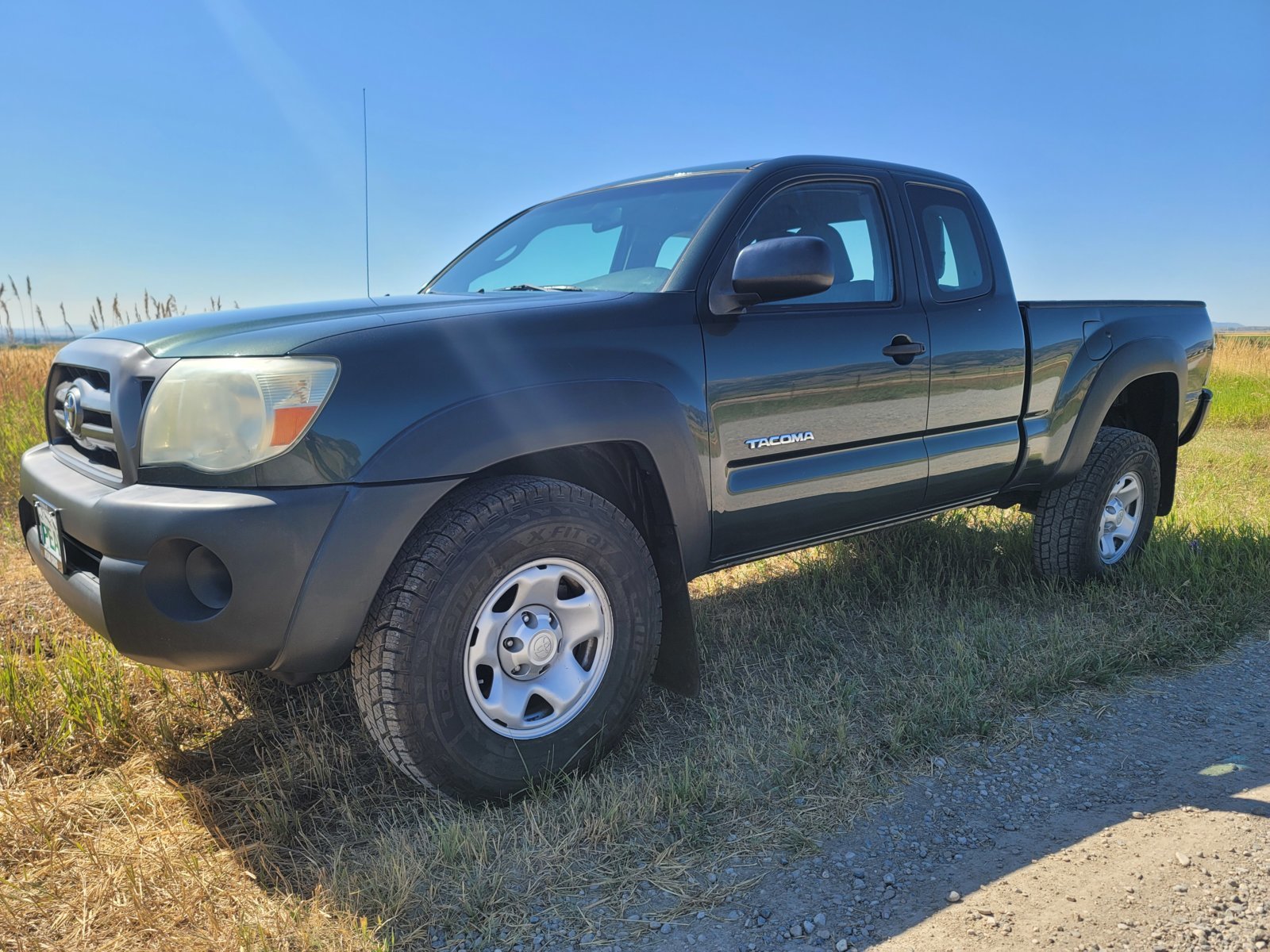

    One other question.
    Is it reasonable at all to expect to get one of these at book value? Every single one listed in my area in decent shape is a full 10-20% higher than what KBB is showing.
  18. Aug 2, 2024 at 10:37 AM
    #18
    randy11
    randy11 [OP] Well-Known Member
    Aug 30, 2017
    #228510
    117
    The 2005 ended up being in rough shape. And was an easy pass.
    The 2009 was actually an SR, not an SR5. That was my mistake from the pictures.
    It was immaculate, and bone stock. Ran great, body and interior were perfect. I took it to a really reputable Toyota specialist, and they said it needs ball joints, but otherwise is in great shape. It had bad steering wheel wobble between 65-75 mph
    The dealer wouldn't replace the ball joints, or negotiate on price at all. Made me absolutely sick walking away from that truck, but their price was already way high. That's my dream color, also.
    Should I have sucked it up and paid? I know I won't find one cleaner.

    #19
    Dm93
    Dm93 Test Don't Guess
    Mar 3, 2015
    #150066
    13,714
    Texas
    2014 DC OR 6spd 4x4
    I would have probably passed too, $20k is too much IMO for what is essentially a base model truck that is 15 years old.

    randy11
    Aug 30, 2017
    #228510
    117
    I'm not comfortable doing my own ball joints either, do that's an extra $1,500 out of pocket for me.
    God damn it was a nice truck though.
