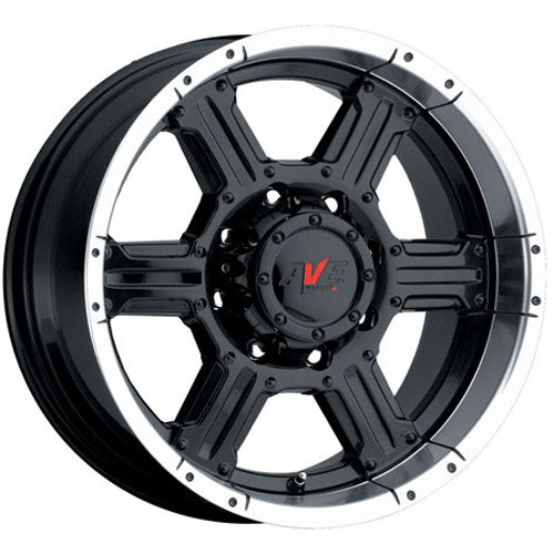

    Just ordered them Holy crap what a deal:eek:
    Black Center with Aluminum Machined Lips
    finally found a wheel that had the perfect balance of Silver and Black that I have been looking for...

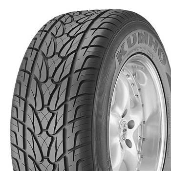

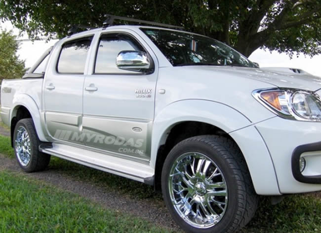

    As for tires I was thinking about getting the Kumho Ecsta STX KL12 Tires like the ones on this Toyota Hilux

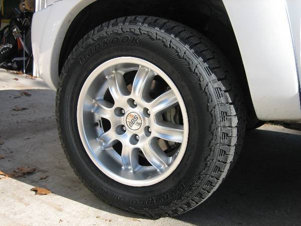

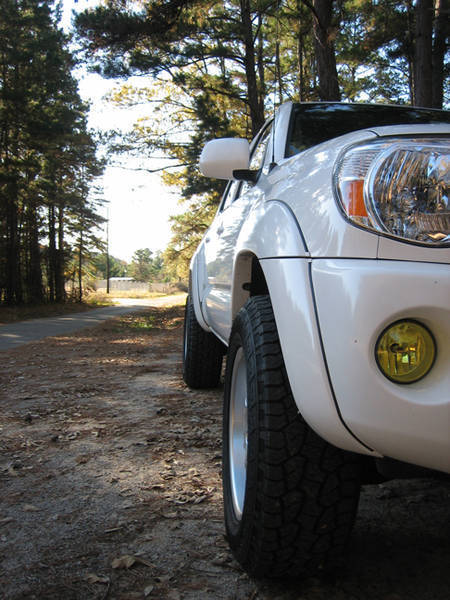

    Here are 265/65/18's on an 18x9" rim +10mm offset. The 265/60 will be around 1 inch less diameter, but will look pretty similar.
