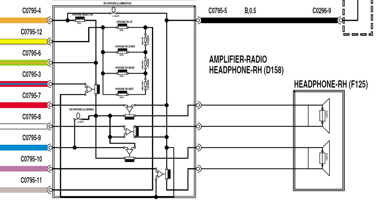

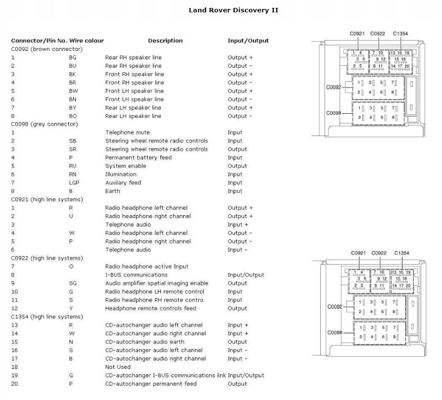

    I've got an issue with my Rover headunit that I could use help to unravel. It thinks there are headphones inserted in the rear control unit(that I do not have), which lowers the volume/bass in the rest of the vehicle.
    I have wire diagrams for the rover wiring, headphone control unit, but not the headunit internals.
    The rest of the radios functions work just fine so I don't want to junk it.
