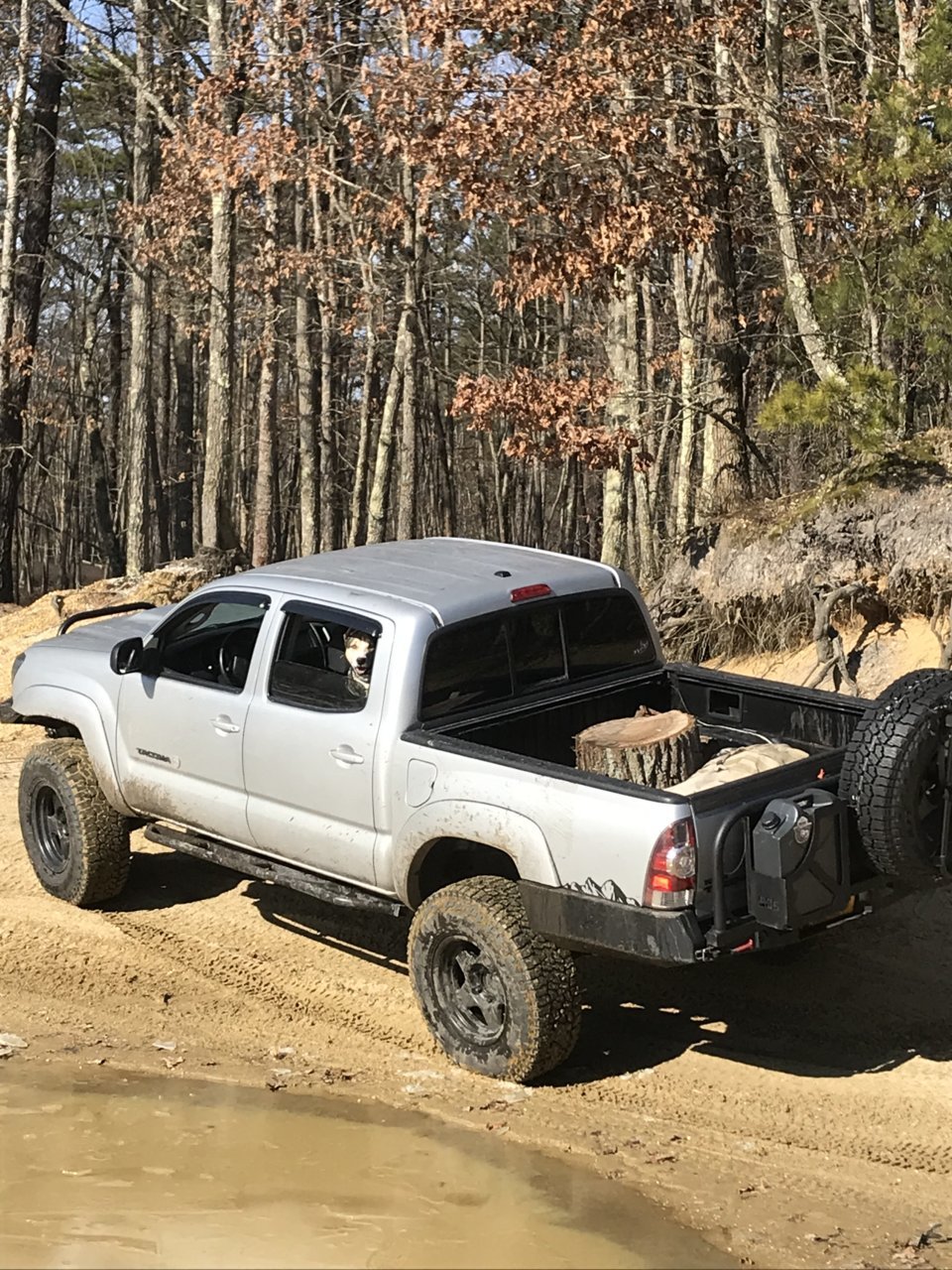

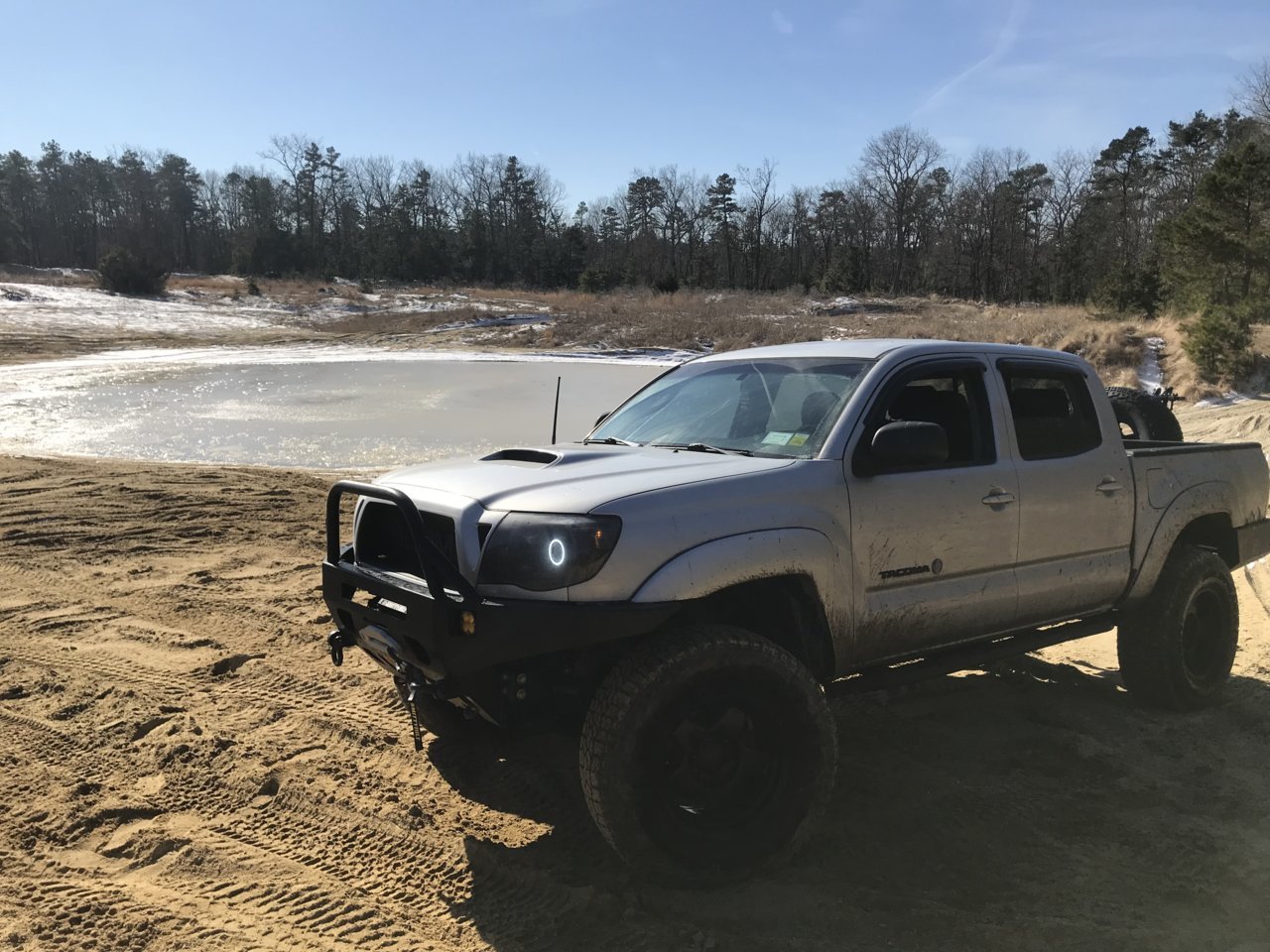

    Lets see some pics
  11. Jan 17, 2019 at 6:51 PM
    #51
    mreen428
    mreen428 Well-Known Member
    Dec 14, 2014
    #144275
    316
    Shmatty
    Queens, NY
    11 DCSB TRD Spt
    8E375317-3BA7-438F-A1EC-AC0BCE0B478B.jpg D90A771E-27C5-44A7-99CD-26AEB0A7081F.jpg B4193915-CFAA-4452-9AAA-8D151ECE6AEB.jpg
    Beefchief, TcoRb, Navy Goat and 2 others like this.
  12. Jan 17, 2019 at 7:26 PM
    #52
    KaptainH
    KaptainH Well-Known Member
    Aug 16, 2015
    #161948
    2,276
    Kris
    Gainesville, GA
    Black 2013 DCLB Sport
    Love it- any regrets not getting something more aggressive? I want the wildpeaks for price and because I do spend a lot of on road / daily driving time. I've got ST Maxx now which have been great offroad but hate on road handling.
