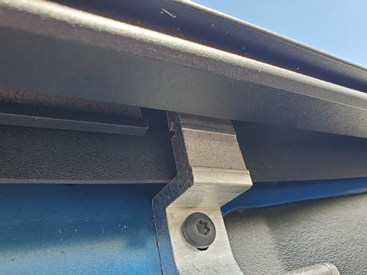

    The cover is secured to the truck using two long rails that run longitudinally on each side of the bed. They are attached to the truck using these aluminum brackets, which mount using the holes from the factory rail system. The original fasteners are re-used. Be sure to use a in/lb torque wrench rather than a ft/lb torque wrench. Only 66.5 in/lbs needed on these little guys.
    While installing these ^^^, pay attention to this little rubber seal and make sure that it doesn't get folded under itself.
    Now it's time to re-install your factory rail system. New fasteners are provided (T30 torx), and again 66.5 in/lbs.
