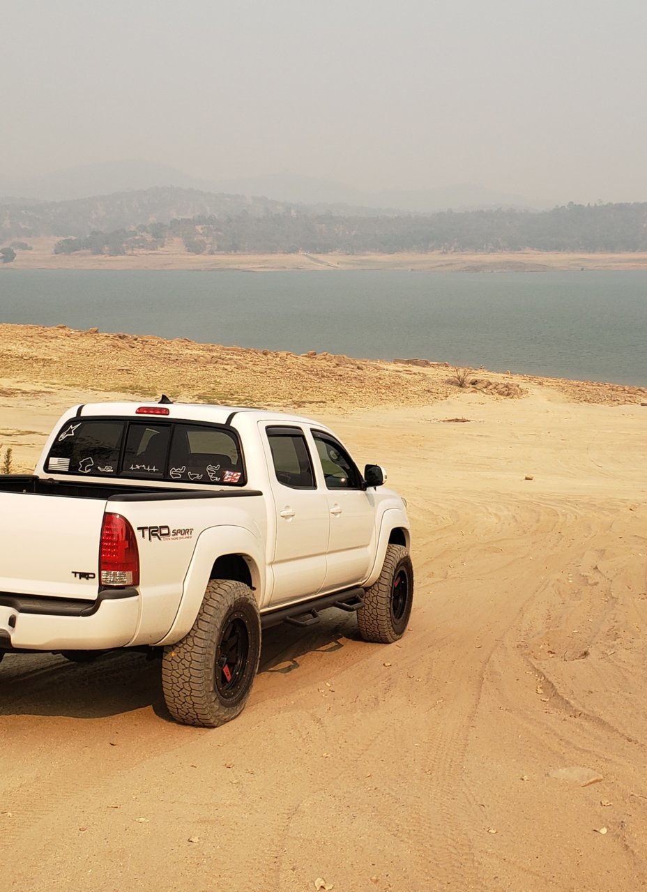

    Sorry I didn't get a notification about your post. Ya they are a little pink during the day but at night it looks totally different. Heres a day pic, I will add a night shot once the sun goes down.20200824_091921.jpg

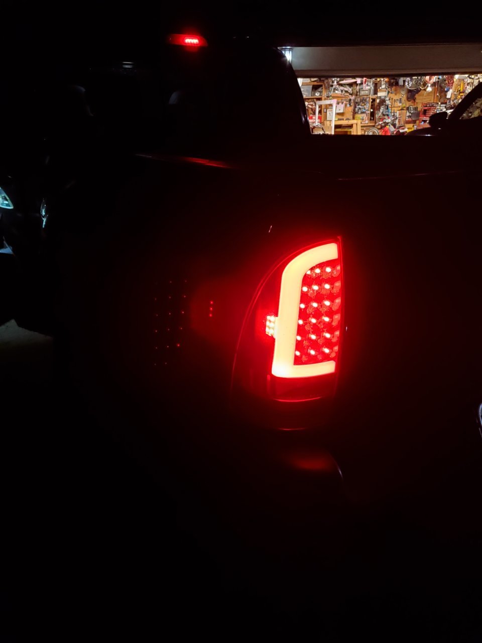

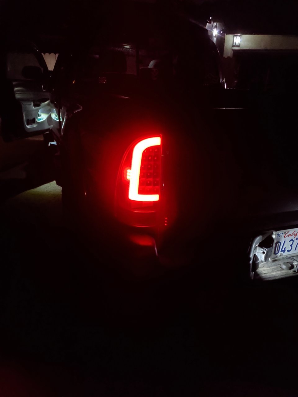

    Sorry for the delay, been busy. Here's a quick night shot.20200826_214024.jpg 20200826_214024.jpg 20200826_214125.jpg

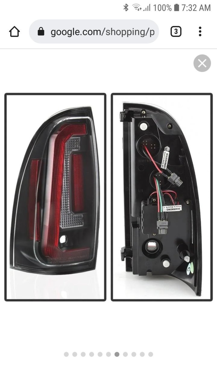

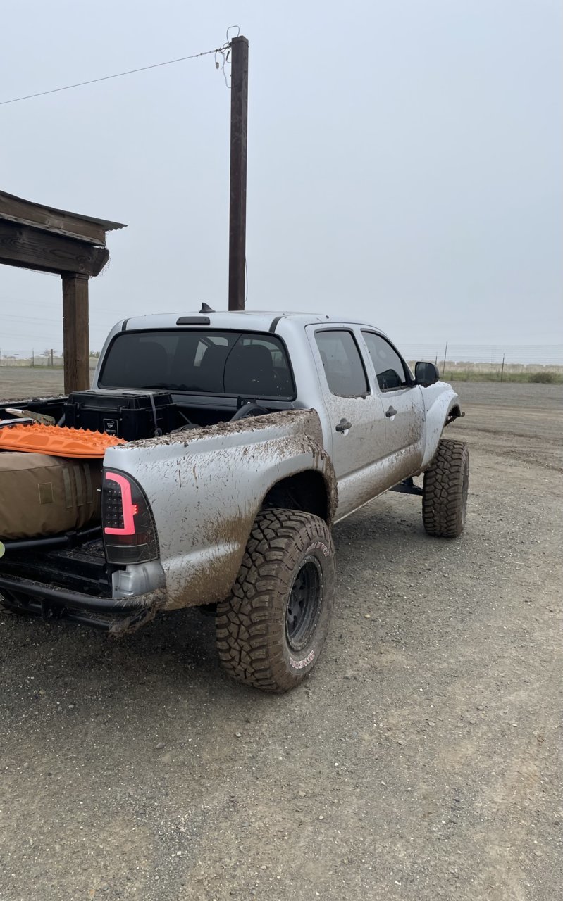

    Thanks for posting the info and part number on this for the wiring harness. Question: Do I need to order 2 wiring harnesses (one for each side) or does that part number come with 2? Thanks!

    Two things:
    1. I can't say for sure what you will or won't need for those specific lights because I don't have them.
    2. No matter what taillights you use, only one harness is needed for each side.
    Basically your stock pigtail harness will either work fine and you won't have to buy anything else, or your existing pigtail harness will be the wrong version and you need to buy the alternate one. More info/photos here on my build thread, hopefully that makes more sense:
