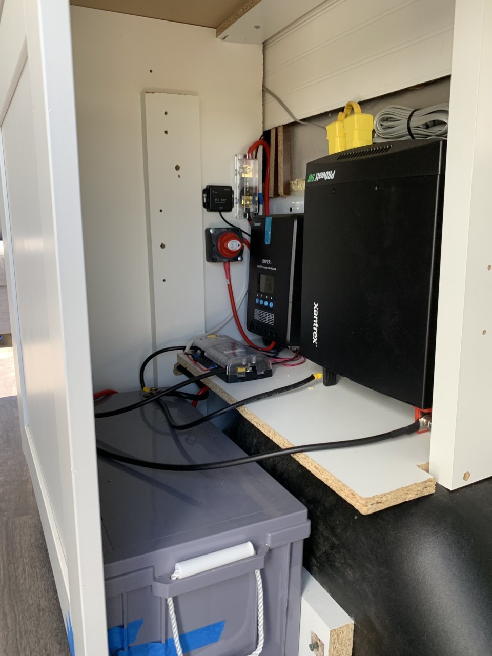

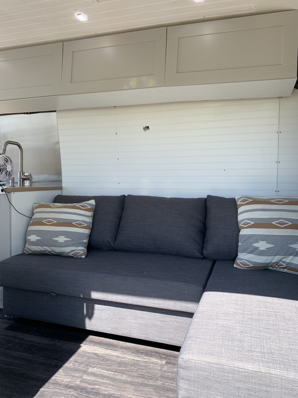

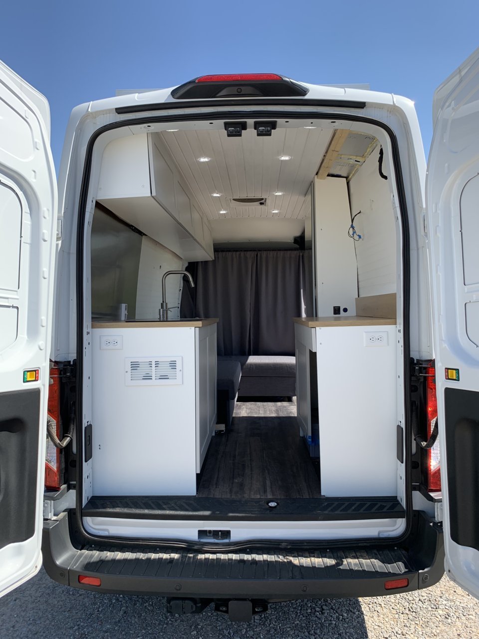

    Thanks! My buddy and I built it and I lived in it for 6 months. Got rid of it when I got the Tacoma (went from it plus a Mazda 3) Been thinking of doing something similar with the Tacoma when I go rock climbing.
    upload_2020-6-5_8-30-32.jpgupload_2020-6-5_8-30-59.jpgupload_2020-6-5_8-31-26.jpgupload_2020-6-5_8-31-39.jpg
