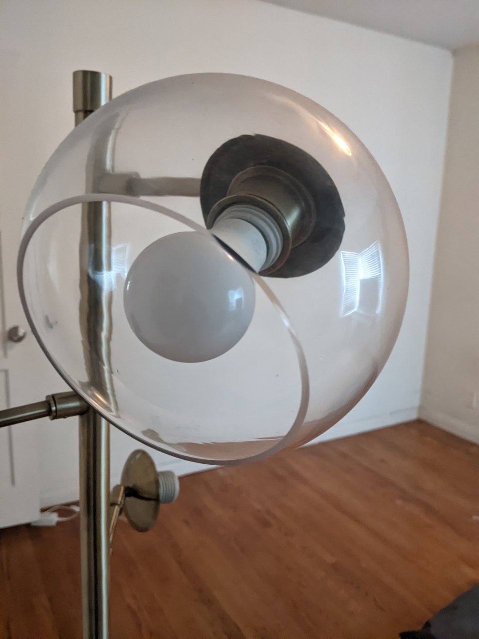

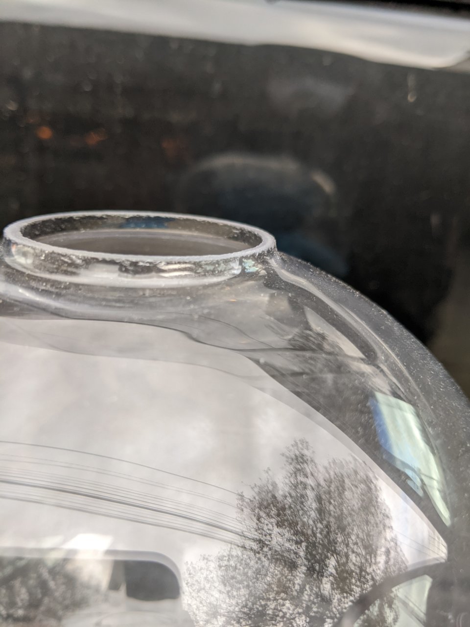

    I guess I really don't even need a glass cutter, just somebody who knows more than I do which is probably most of you guys. It's kind of a long annoying story, but I have these three super cheap thin glass globes that I need to shave a lip off of. I need them to sit flush inside the housing and this tiny lip is in the way. I called a few local glass companies and they want way too much money, but one of them told me to try using sandpaper. I tried it but it seems to be taking absolutely forever so I'm just wondering if I could try a Dremel on a super low speed as to not crack the glass.

    That's what I've been trying to do now, was modify the other part but I don't think it's possible. I accidentally broke one of these glass globes from my roommates fancy lamp. And it's ridiculous, but pottery Barn does not sell the glass separately whatsoever and it is a very odd size. This is the closest thing I could find and it came from lowe's, it's a very cheap thin glass but it fits in the old lamp housing other than it won't sit flush because of the little glass lip. I was thinking of using some kind of spacer between the glass and the housing but if I could take down the glass it would be the best way.

    No, it's a glass globe made for a lamp, at least that's how Lowe's sells it.

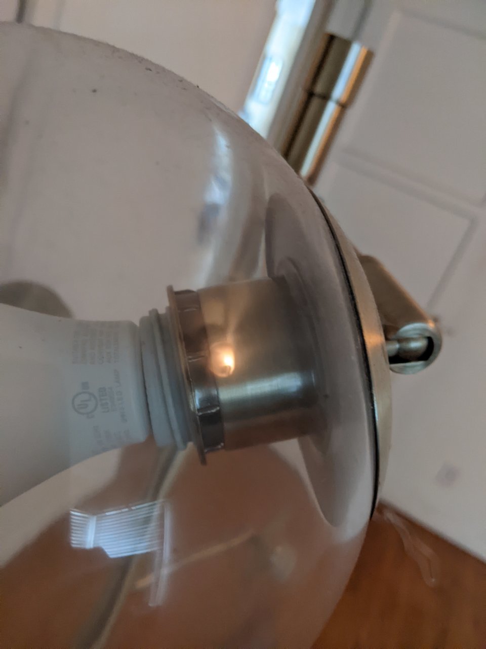

    How in Rudy's name is it held in?

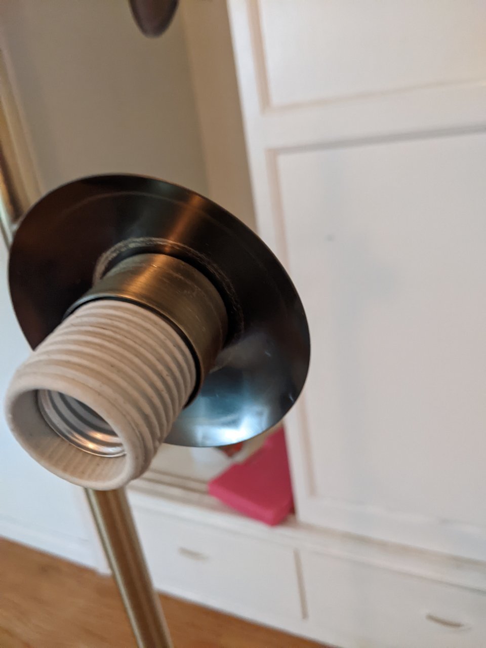

    Can you modify the lamp base instead of the globe?

    There is a separate piece that screws it down and just clamps the glass.

    That's what I was trying to do yesterday but it's literally just a flat piece so I don't see how.

    That one is the original globe which sits flush against the circular base and is much more high quality glass, but of course they don't sell replacements at all. They want me to buy a new lamp at over 200 bucks.
