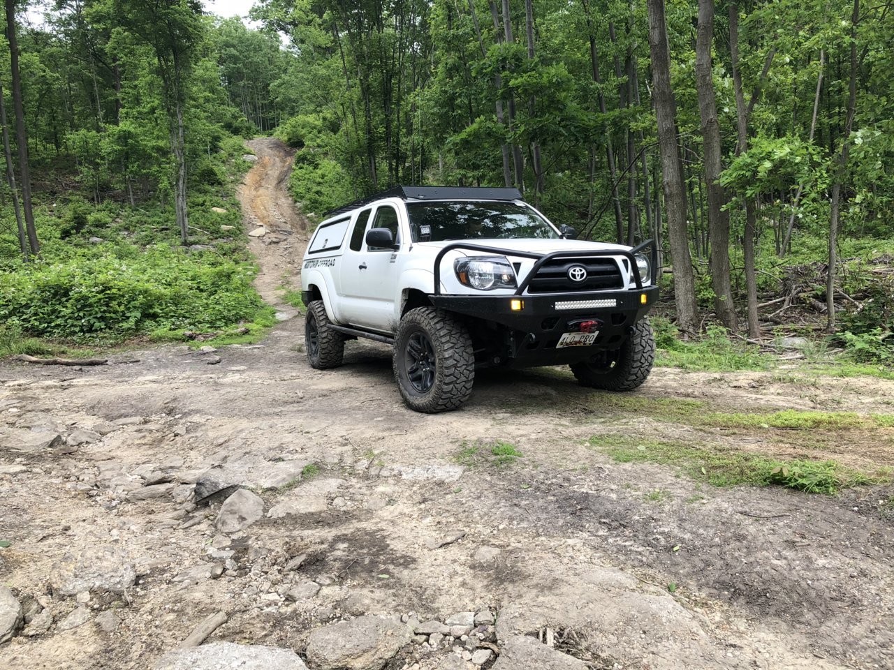

    I just want a setup similar to this picture. Something with a good "aesthetic" look, good on light off road, and a daily driver.

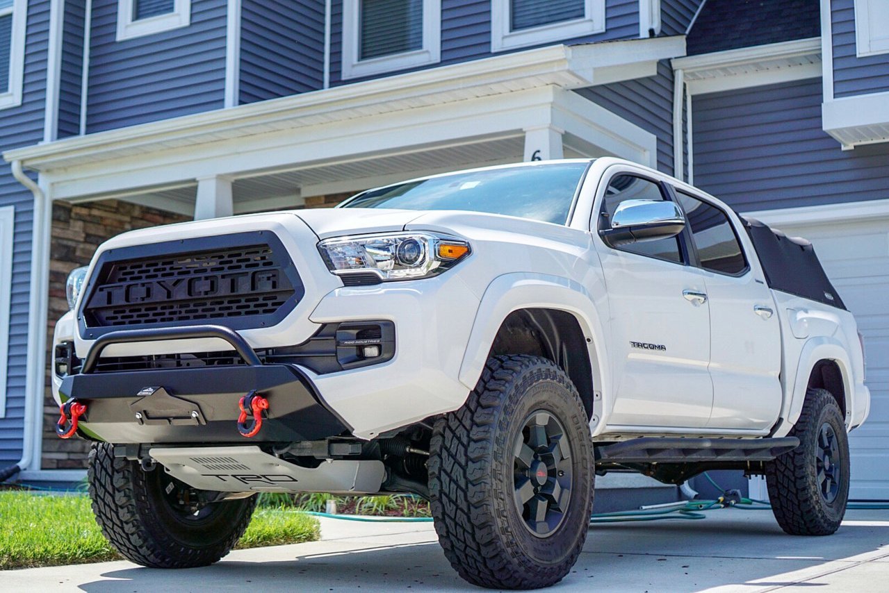

    Yeah that does look pretty sexy. Is something like this not high enough?

    This is just a 2” lift
    Look through this forum below for suspension setup. A lot of good info
    https://www.tacomaworld.com/forums/suspension.18/

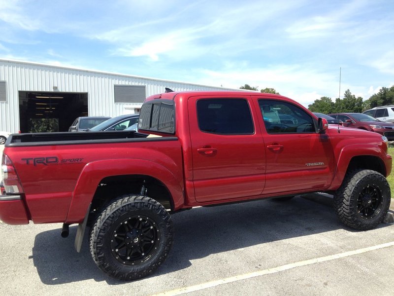

    Fuel Hostage 18x9 with 285/65/18 Nitto Trail Grapplers
    Maxtrac 4" spindle, Fox Shocks, OME Dakar Leaf Springs.
    Is the parts listed on that truck I saw online..guess it's a 4x2.
    What similar setup can you get 4in lift from thats quality but not breaking the bank?
