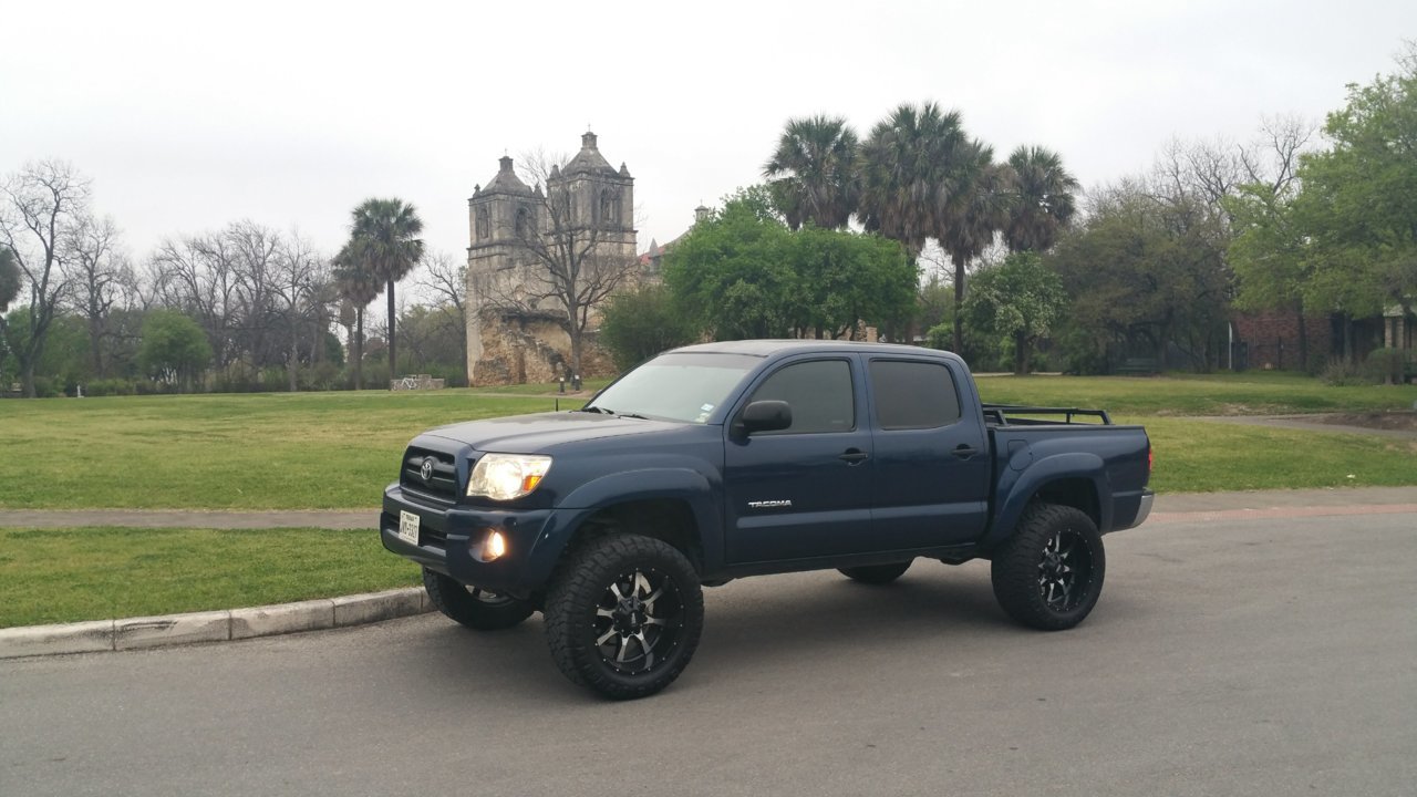

    4 in suspension lift , rear fox shocks, 33's nitto ridge grapplers, 17x9 Ray 10 Dark Bronze Deep Dish, VIP led taillights, morimoto fog lights, A pillar mod with xgrip ram mount, x grip ram mount with panavise by a/c controls, cargo/ tire carrier by Kore 4x4, softopper, Maner Edition Rock Sliders
    Here is mine 4 inch lift with 33x12.5x2020180318_080537.jpg 20180615_153321.jpg

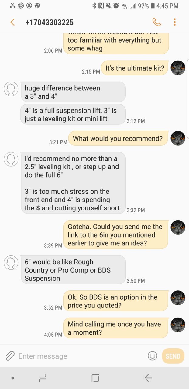

    What 3in lift woukd you recommend, or is it the fox one you posted? Also, I've read and been told 3in puts a lot of strain on the front. This is what he recommend.

    It's the RC 4 in suspension lift (drop bracket) no issues very light trim since I have 12.5 wide tire, feels great for me don't do much off road just slightly , if you really want to run 33's do a 4 not a 6 doesn't look right unless run 35

    Nice! Did you change the shocks? Also what offset etc is yours at?

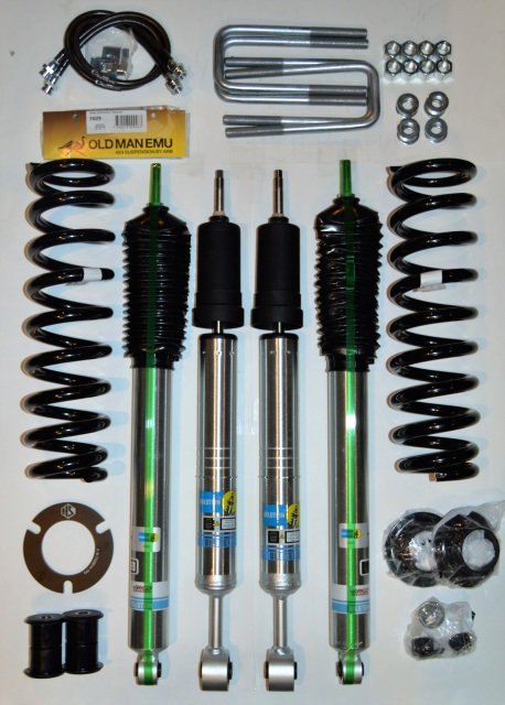

    There are 4 shocks on the truck, two in front and two in the rear. They're referring to bilstein 5100s. Now, it's two different kinds of shocks, but they're still all 5100.
    Here's a visual of the 4 shocks. As you can see, two different kinds.
    So all a shock does is it handles rebound from the spring. If you didn't have shocks, your ass would be bouncing down the road like crazy. In the front of the truck, the coil (pictured above) is what actually provides lift. These can be different lengths and firmness depending on someones set up.
    In the rear, the leaf springs is what provides the lift/holds the weight of the truck.

    Change the rears to fox performance the front are oem you are able to keep everything proportion with a drop bracket from factory which is good unless you go with adjustable Upper control arms more money, wheel are 20x10 with -24 offset

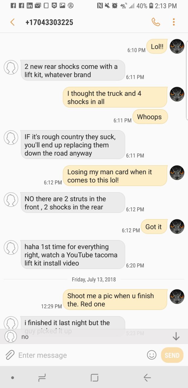

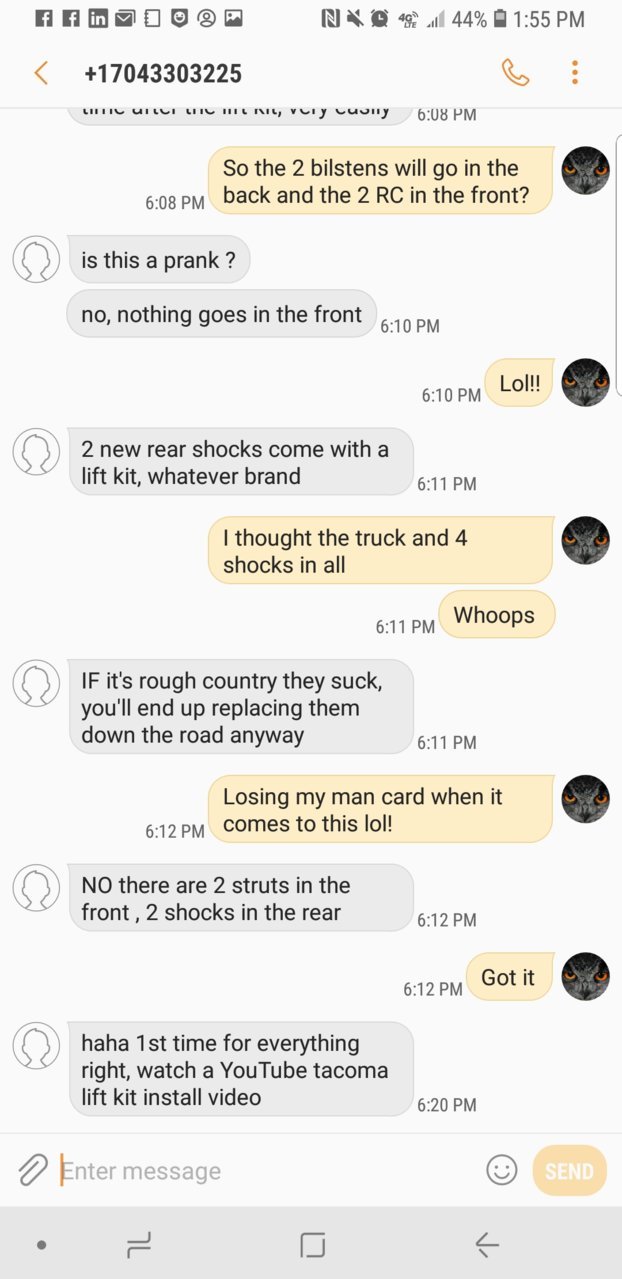

    That's what the guy recommends if I went with the rough country, switch to 5100s bc of the RC shock. So if I went to order the 5100s I would order 4 and not 2? He said I would just need two to replace the ones with the kit.
