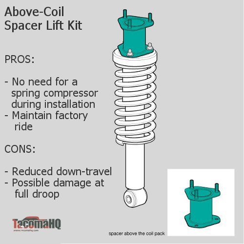

    The way the lift works in the front is a giant spacer is put on top of the factory shock.
    In the rear, you put a large black in the back between the axle and the factory leafs, and then install the RC rear shocks. Those would be the ones you would replace, but really I don't think that'd improve much of anything.
    Blocks are not a good lift. They cause axle wrap, which is bad. That's why a full leaf pack replacement is ideal, like I talked about earlier.

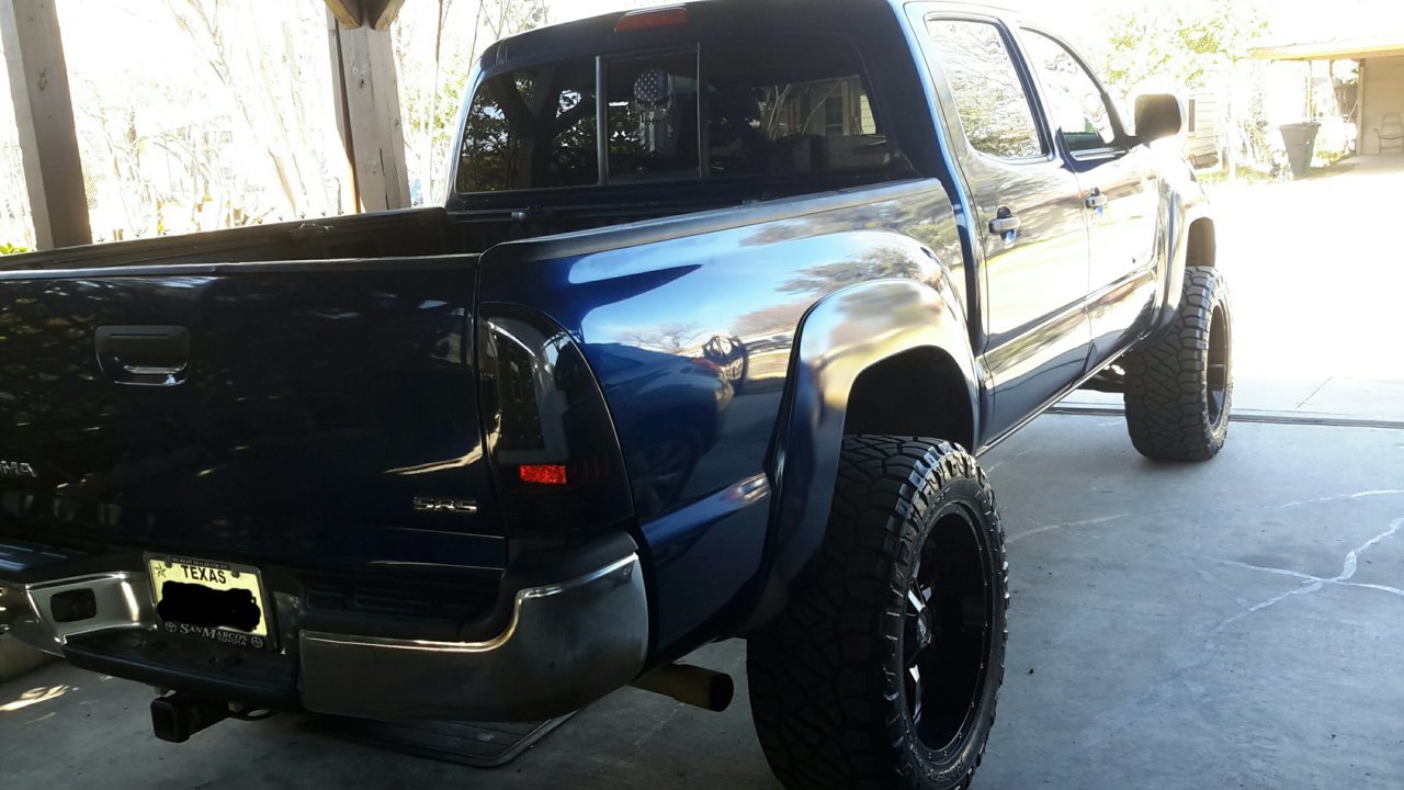

    I'll take a pic later on how far it sticks out only pic I have for now
