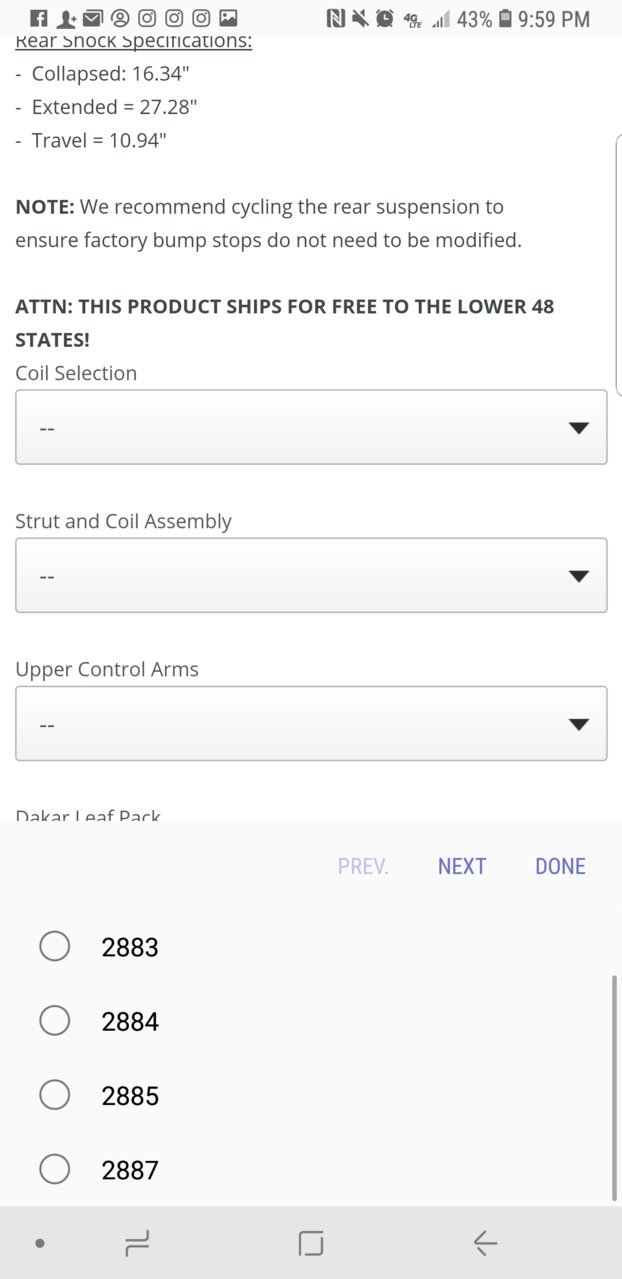

    How do you decide on spring?

    Each one provides a different amount of lift based on year of truck, cab configuration, etc.
    What’s yours?

    18. What would provide the max? And is a new control arm needed. I'm looking at the OME, fox and 5100 kits

    Double cab? Access cab? Long bed? Short bed?
    888 would provide the max, and you can always add 1/4” and 1/2” spacers on top to max it out and get 3”. If you did that then you would need new uppers.
