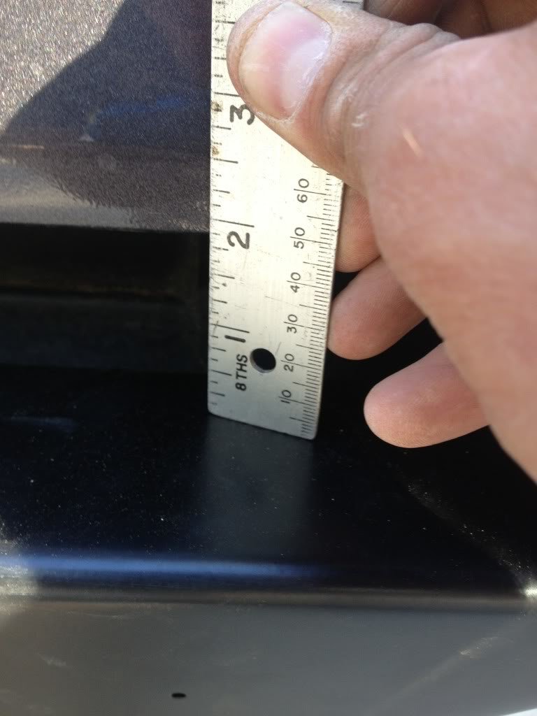

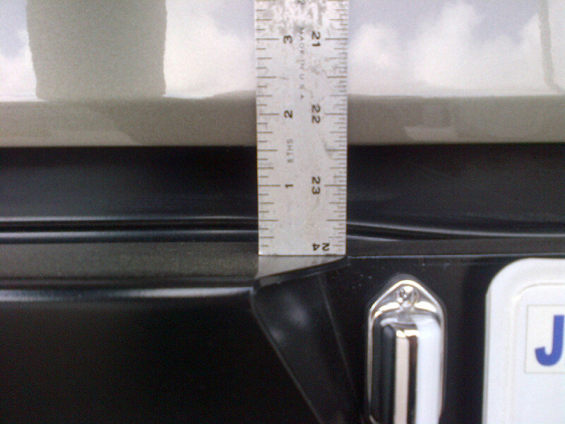

    Yea that is a little low compared to mine. Around 3/8" lower?
    Loosen all the bolts and use a HL jack to push it up. I did that to one side at a time to level it out.

    Did you install the hitch after you set the bumper? I cant see how my bumper will go higher because the hitch is bolted in and wont go higher.

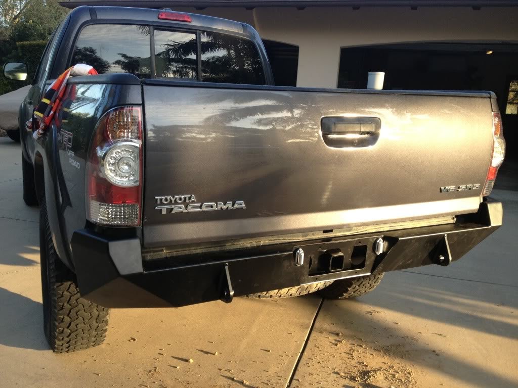

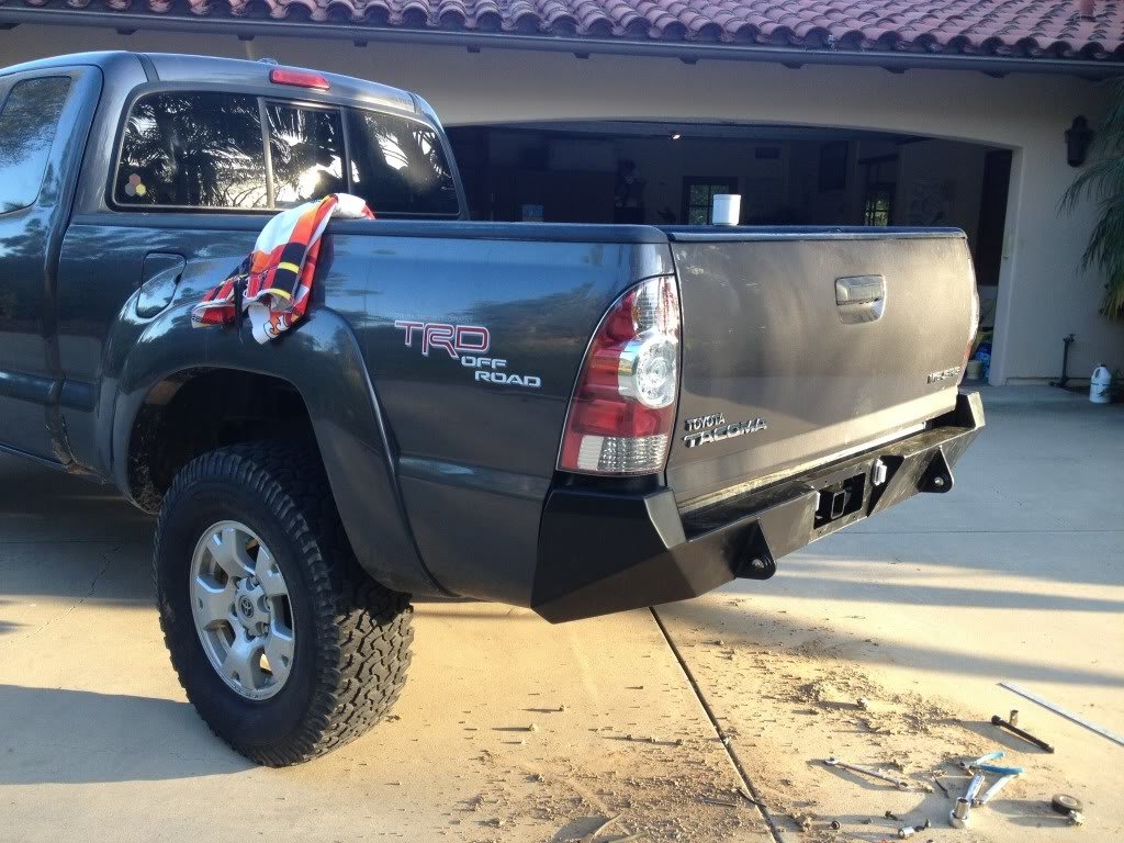

    Got it to sit higher, had to use some redneck methods.

    ^ Hey whatever it takes. But I did put the hitch on first which made it easier to put the bumper on cause you could kind rest it on the hitch while getting the first couple of bolts on.
