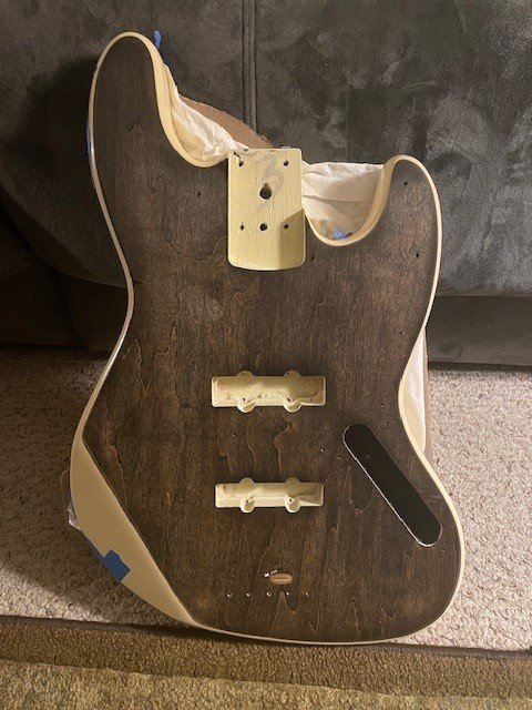

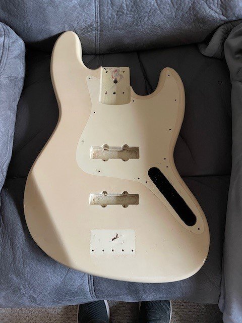

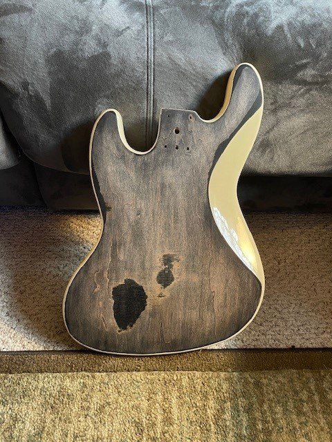

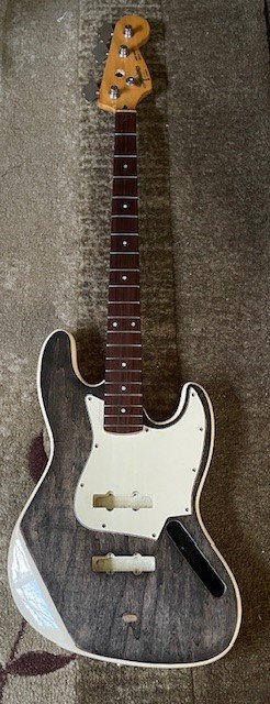

    Pic 1 - body in its original state. I didnt think to take pics before I had it disassembled.
    Pic2 - (Back) started with a heat gun to remove the paint. took about 10min to realize sandpaper was a far superior approach in this instance. Stained black. The dark spots are where the top lam lifted away with the paint. when sanded clean, there was no discoloration, but the stain really soaked in the next ply. Gave a sort of "relic'd" look. Sanding was a bit aggressive at the horns, and bottom side, but also seemed to lend themselves to a worn look. was sanded to 320 prior to finishing.
    Pic3 - (top) sanded by block and hand to only 180. I wanted a more rough texture to the wood, and let the TungOil varnish fill to smooth. this was in the hopes of a little more depth and light refraction. May add a few more coats prior to completion.
    Pic 4 - just laid the PG and the neck in place to give an idea... If I saw it hanging in a store I would probably not give it a second glance. but it is growing on me all the time. Once I get the electronics, it should be a beast.... HopefullyJB 1.jpg JB2.jpg JB3.jpg JB4.jpg

    I like it! It's gone look even better once you install the other parts.

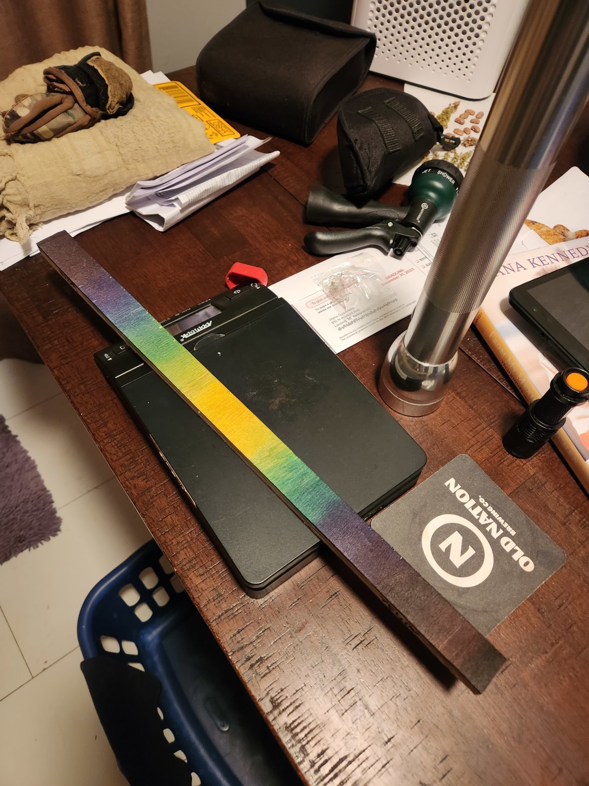

    Testing out a color scheme for the Tele refinish. The wood there is very soft and porous, unlike hardwood, so it's not perfect, but gives me a example.

    I have seen people stain and then airbrush the sides and fade in for the sunburst kinda look. Sometimes stains just won't work the way you need them and they like to mix with other colors. Blue is a pain to work with likes to turn green and purple really easy.

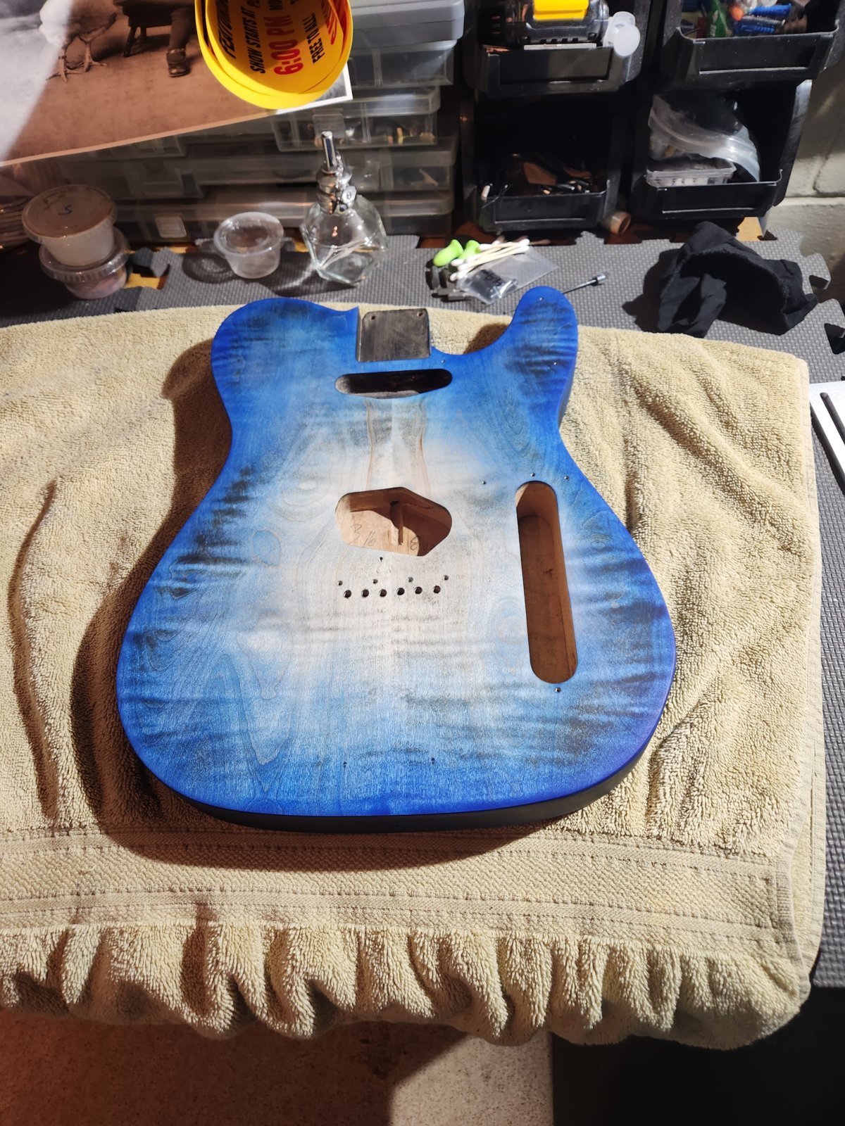

    I just bit the bullet, diluted blue 1:40 with neutral and came up with this color. It was so dark before it was almost purple.
    This is the result. The center is neutral. It should turn kinda yellow once I finish it.
