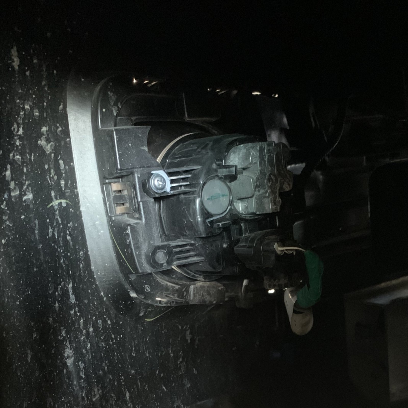

    Hi all,
    I have a new pair of LED H11 Lamp bulb with me. I wanted to try this on my 2022 TRD OFFROAD, if it is better than my factory LED fog lamp.
    Cougar Motor H11 LED Bulbs, H11 Light Bulb 30000LM 120W Ultimate Extremely Bright H9 H8 Fog Lights 6500K Cool White Adjustable Beam,
    I thought just counterclock wise for removal (like Halogen) but it seems to me, isn't. Direct me a post or for a step by step removal instruction would be much appreciated!

    I believe those are integrated assemblies

    If you have OEM LED they are sealed units, you can not swap the bulb. Very fortunate in your case as the OEM LED units will be drastically higher performing than the pathetic Chinese garbage products you were looking to replace them with. If you want better still you’re going to need to look at replacement assemblies from Diode Dynamics like the SS3s or Elites.

    if you look at op's picture its an led
