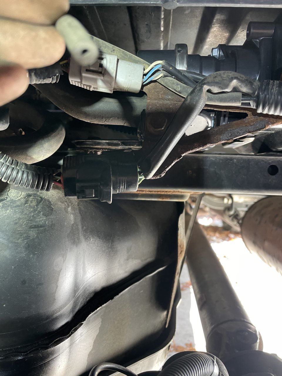

    I was changing out my vapor canister yesterday and found this lose vacuum line. Does anyone know if it should be attached to something? Nothing jumped out at me. It’s coming from what looks to be the rear diff harness.

    Is that your diff breather????
    Where does the other end go to?

    No, I’m familiar with the rear diff breather. I just replaced it because it had rusted shut. It follows the wiring harness down to the rear axle though. Does the locker need a vent?

    If you have the electronic rear locking diff it will go to the frame rail crossmember it is a vent for the actuator.
