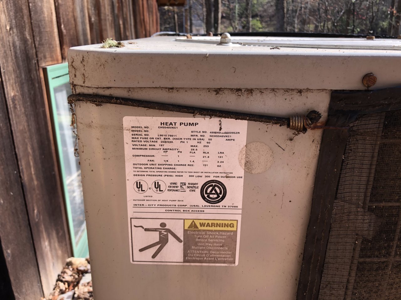

    I don’t know. I know we have a unit inside and outside.
    The outside unit that says Heat Pump
    I say it was getting stuck in both modes, but honestly at 89 degrees in the house.
    All I know it the fan was blowing in Cool mode as well. I was sweating balls trying to get it to just turn off. I can’t imagine what the electric bill will be this month.
    Anyways here is the unit that had the problem.
    It’s fixed as of now, and I don’t want to mess with it any more.
    All works fine as of now.

    Based on that data sheet, I can tell you that you’ve got a 48,000 BTU (4-ton heat pump manufactured in either October 1996 or the 10th week of 1996 (which would put the manufacture date in mid-March).
    It sounds like you had a hiccup with the thermostat. If you have any more issues, please keep us updated; Also, I would highly recommend that you monitor the outdoor unit closely over the next few days and see if it seems excessively frozen.

    Yup that’s your contactor.
