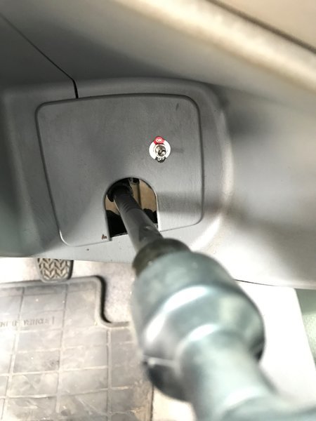

    I don't notice anything happening when I toggle it.
    I have an aftermarket stereo with backup camera but the switch doesn't do anything to it, although of course it's possible the wiring is bad.
    I bought the truck a month ago.

    That's a generic switch, you can't really tell what it does by looking at it.
    The only surefire way to tell what its purpose is is to remove the panel and trace the wire as far as you can, it's bound to lead somewhere.
    It could be a variety of things like off-road lights, driving lights, some kind of LIGHT, accessory power, etc etc. The possibilities are endless.

    Might be yellow wire mod or abs kill switch?

    It could also be a valet switch for an old alarm system

    My best guess is that if the wire leads out of the firewall, it's an aftermarket accessory. If it's connected or spliced to the factory wiring harness somehow it can disable/enable some factory function such as ABS/Traction Control.

    I'd bet on kill switch or valet/override. OP, do you have an alarm?

    This could be a switch installed for your aftermarket stereo to ground out a parking wire,giving you the ability to watch dvds, go into settings or even some gps functions while your driving. I have that exact same switch that was installed by a stereo shop to allow me(passenger) to have complete control of the unit even while driving

    You said it had an aftermarket sound system, does it have a double den radio? It may be to override the parking brake lockout to watch moves driving down the road.
