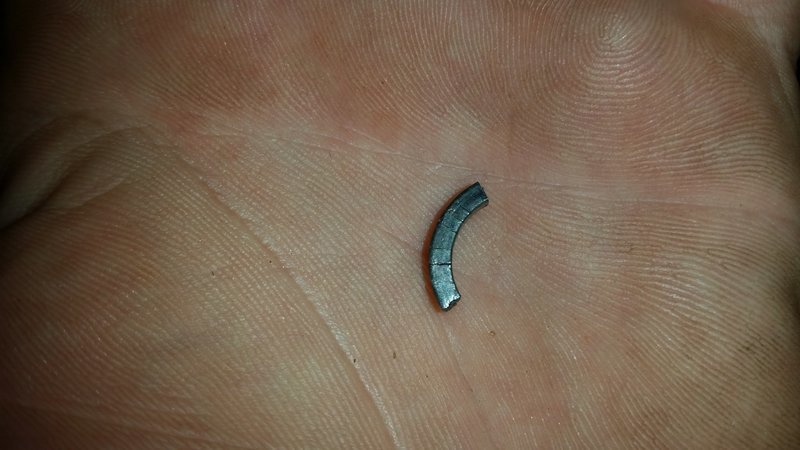

    I recently changed my flexplate and in doing so I discovered this in the bottom of the bell housing behind my torque converter. I thought it was part of my old Tranny pump seal originally but when I changed it out I thought otherwise...upon completely reassemblin the drive train and filling with tranny fluid it started pouring fluid out after about 60 seconds of running...could thus be a seal from inside the tranny or what?!?! I'm at a loss. I only found 2 pieces and when you put them together it looks like there's another one that's s'posed to make up what appears to be about the size of a dime

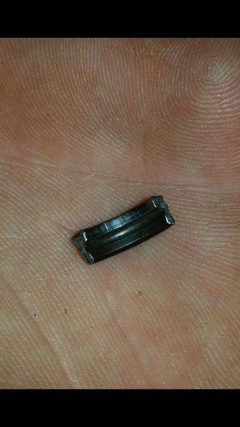

    I have another pic but I can't get it to load

    Finally got to upload

    Looks like a piece of a shaft seal. Should be two more pieces somewhere.

    Yea I was thinking something like that...but is this big enough?...it's just a hair bit smaller than a dime when you hold the circumference of it up to one

    When the transmission pump is installed , there are rubber O- rings on the pump bolts that your seal would fit perfectly .
    Its not uncommon to see the odd left over part . Could have been there since the time of assembly ?

    Looks like part of retainer off of starter shaft

    The outer edge has had some serious abuse and the are several stress cracks in thus single piece
