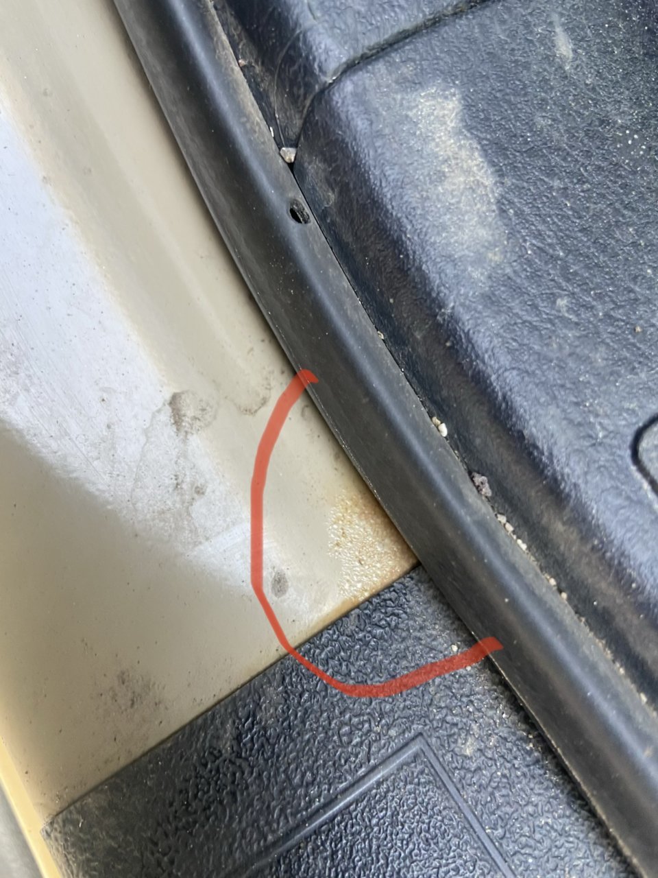

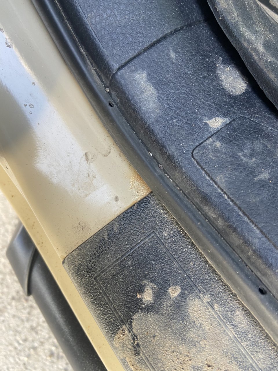

    So my paint in my driver side door sill is bubbling and seems to have rust coming up. It appears it may be under the door sill protector as well. I’m not overly concerned as it’s in my door sill but I would like to prevent it from getting worse or spreading. Any ideas? I was thinking maybe sand and primer, followed by touch up paint? I’m no paint or rust expert so any advice would be appreciated. I’m no longer under warranty. Here’s a couple pics.BFC31EE3-6992-4C58-9F7F-A764BA59528D.jpg5893DCC1-463A-4347-8145-8F6AC23F2382.jpg

    There is a TSB for this, take it to the dealer and check if yours is covered. Rust is longer warranty than your base warranty.

    OP Thanks for the post. When I Fluid film my 2020 shortly when the temps warm up I'll be sure to inject some FF into the shown holes in the door gaskets on the bottom of the door sills ....

    When I FF my truck, I pulled all the rubber plugs in the rockers and sprayed a ton inside the rocker panels.

    They only note it under the 3/36 unfortunately in the tsb

    True, but their rust warranty is 60 month unlimited miles. So there is a chance of getting it covered anyways.

    Wash your truck and wax the door sills. Lack of attention to detail. I would be pissed if my 18 looked like that. Try the dealer but don’t be surprised if they turn you away. I would cringe if my plastics and metal looked like that.

    Pull the sill trim up, then pull the door seal off. You will be able to see if there is any rust right there on the pinch weld.

    Yea I’d have to say that would not prevent this regardless (you may notice it sooner but that’s it). The bubbling you’d see is not the first signs! Pull the sill scuff plate and it will originate at the pinch weld caused by water running down the weatherstripping. Look at the tsb and read the repair procedure- they add a sealer to the spot weld along with a clear flange tape
