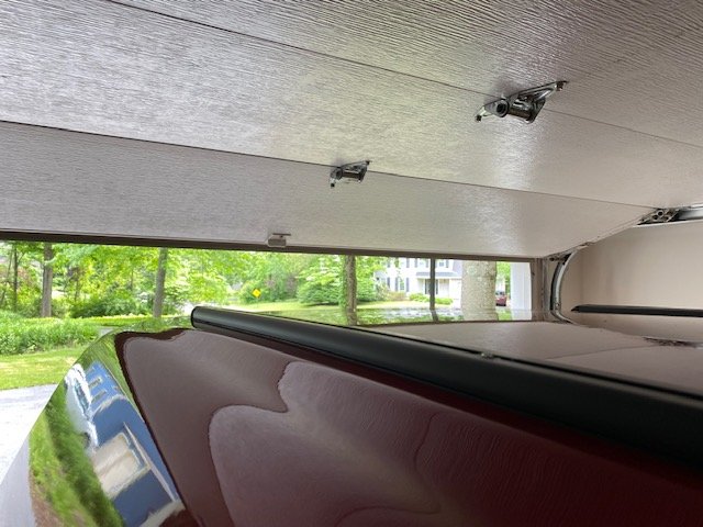

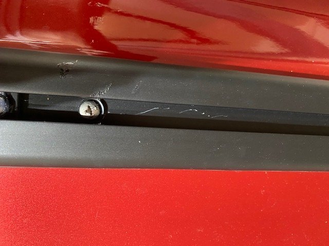

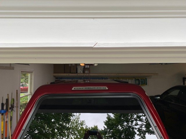

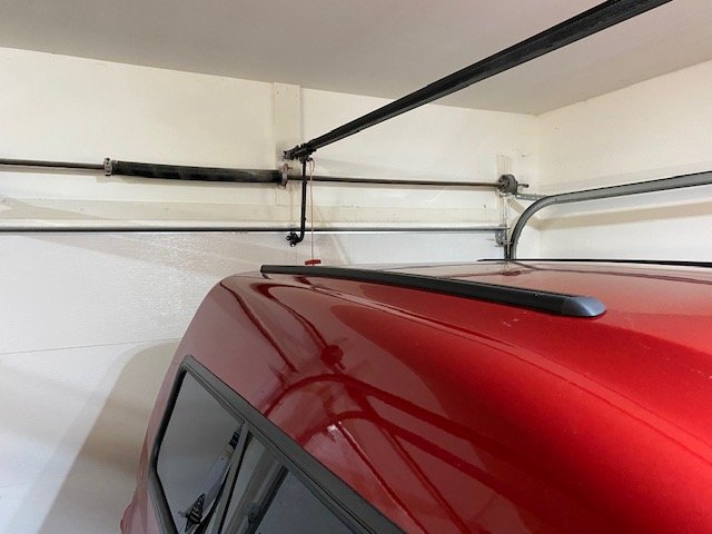

    I have height issues in my garage as I have 7 ft garage doors. With my new cap I have 3 inches to mount solar. I have rails on the cap but would ideally need something that mounts on these rails that doesn't sit as high as say the typical Thule feet. I would appreciate any suggestions and I'm hoping someone here has already blazed the trail. Thank you

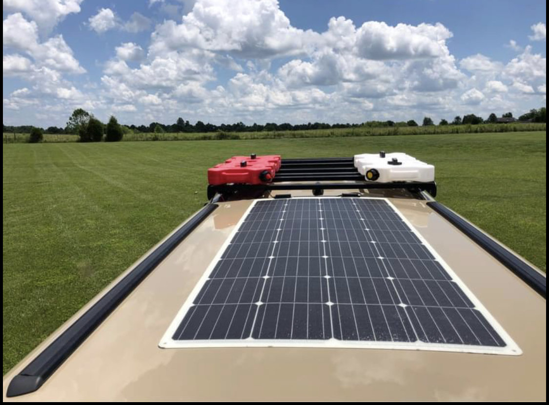

    Do you care what type of panels? Rigid vs flexible? Rigid panels are superior but you may be better off just setting a flex panel in between the rails and using VHB tape to keep it down.

    I have a flex panel on top of mine with the 3m adhesive backing that I tie into a portable power station. Works great.

    I was hoping to get something more efficient than the flexible panels as most are in the 15% range also I worry about it being mounted directly to the top since the brands I've looked at require an air gap.

    If you are not wanting to do flex and adhesive. Why not make you some simple aluminum brackets and use the T channel on the topper?

    OP is having clearance issue and the solar brand OP is looking at need an air gap below it. I don’t think anything will work if OP has only 3” of clearance. I think the best solution is mount it above the cab since OP isn’t interested in the flexible panel.

    So I can think of a couple options. Use Angle aluminum across front and back and mount a panel between. This will give you a gap below the panel the thickness of your tracks. Panels are about 1.4 inches thick so this would give you probably 2” total height off of cap. The next step up that i would consider is something like a 1x2 aluminum extrusion front and back of the panel instead of angle. A little beefier and still height would be the same as the panel is the thickest part.

    You should be able to find some 90 degree brackets in stainless online. One side bolts to the panel(s) the other to your roof channels. The air gap provides cooling airflow and doesn't need a set distance. On my old rig I bolted thru the Thule rod holder thingies thru the shell and used 1/4” aluminum flat stock on the inside of the shell to distribute the force of the nuts/bolts so they wouldn't rip out. Got the flat stock at the big box home improvement place. Use silicone on the bolt heads to prevent leakage. Silicone is cheaper than a leak so don't be shy.
