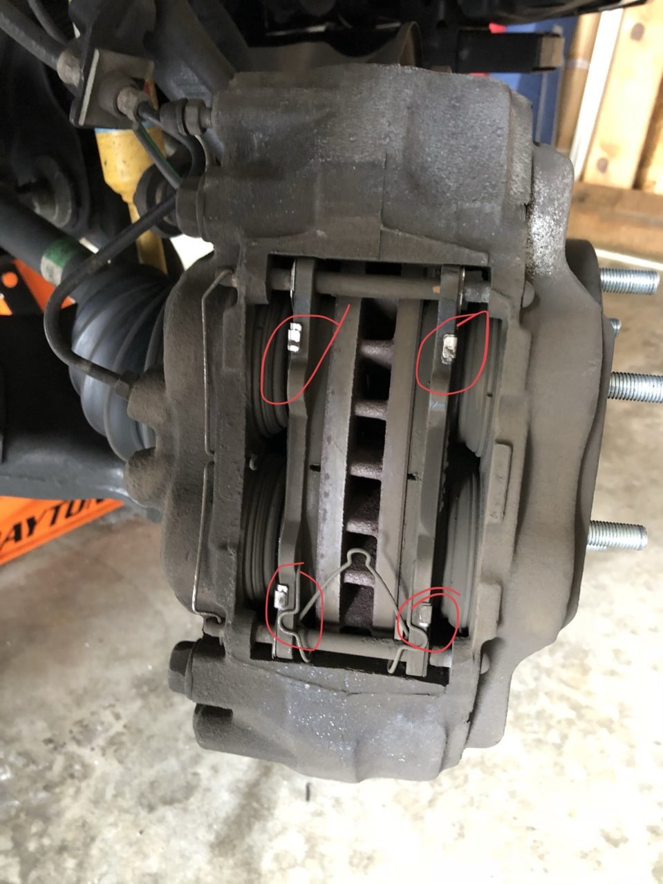

    So, my brakes began squealing and being at around 27k miles, I figured its time to change the pads with all the off-roading and heavy wheels/tires putting more strain on the brakes (lets not forget my lead foot as well). So I removed the brakes last weekend, I was going to put on new pads except that the rotors looks tarnished and slightly worn. I removed them and took them to a local shop to have them refinished, they told me that they had rusted and then measured them and they came in too close to safely refinish given the rust spots.
    I bit the bullet and bought new rotors, put them on and somehow the new pads would not fit, so I put the old pads on and drove it for a week. Same thing, same occasional squealing when cruising and it sounds like theres a pebble lodged between the rotor and pad. I kept driving thinking the old pads need to wear down to fit flat with the new rotors. This past Saturday, I put the new pads on and the same thing, occasional squealing both under braking and when just cruising.
    tl;dr - Brakes, mainly front passenger side, squeal even though I changed both the pads and rotors and doing a few detailed inspections of the brakes and their surrounding areas. It has caused an alcohol dependency with me trying to figure this out.

    I would take the pads back off. Clean the rotors with brake cleaner. Take the pads and make sure you dont have anything on them. I usually take the pads and lightly scuff the surface on cement to get any weird film off them.

    Most of the brakes pads I’ve done have shims on the back between them and the caliper that have to be greased, they’ll start making noise if they dry out. Not sure if the 3rd Gens have them

    I did not see any shims, I did see a spring like pin to keep the pads pushed away from the rotor and another spring like safety pin to keep them in the brake shoes

    You should have stainless steel shims one solid one vented for a total of two on each brake pad...that’s how they come from the factory. It helps if you spray the back of the pads with disc brake quiet then install the shims.

    Brakes don’t squeal from the pad touching the disk, so if they were squealing before, changing disk & pads will not be a permanent fix. Brakes squeal from movement / vibration in the pad against anything it touches (brake piston, brake caliper, retaining clip) or from caliper movement against its pins. Pull everything apart, clean it up, use copper grease on appropriate areas, put them back together. It’s usually a buildup of crap / rust in particular areas that causes it, so cleaning and copper grease is the best option.
