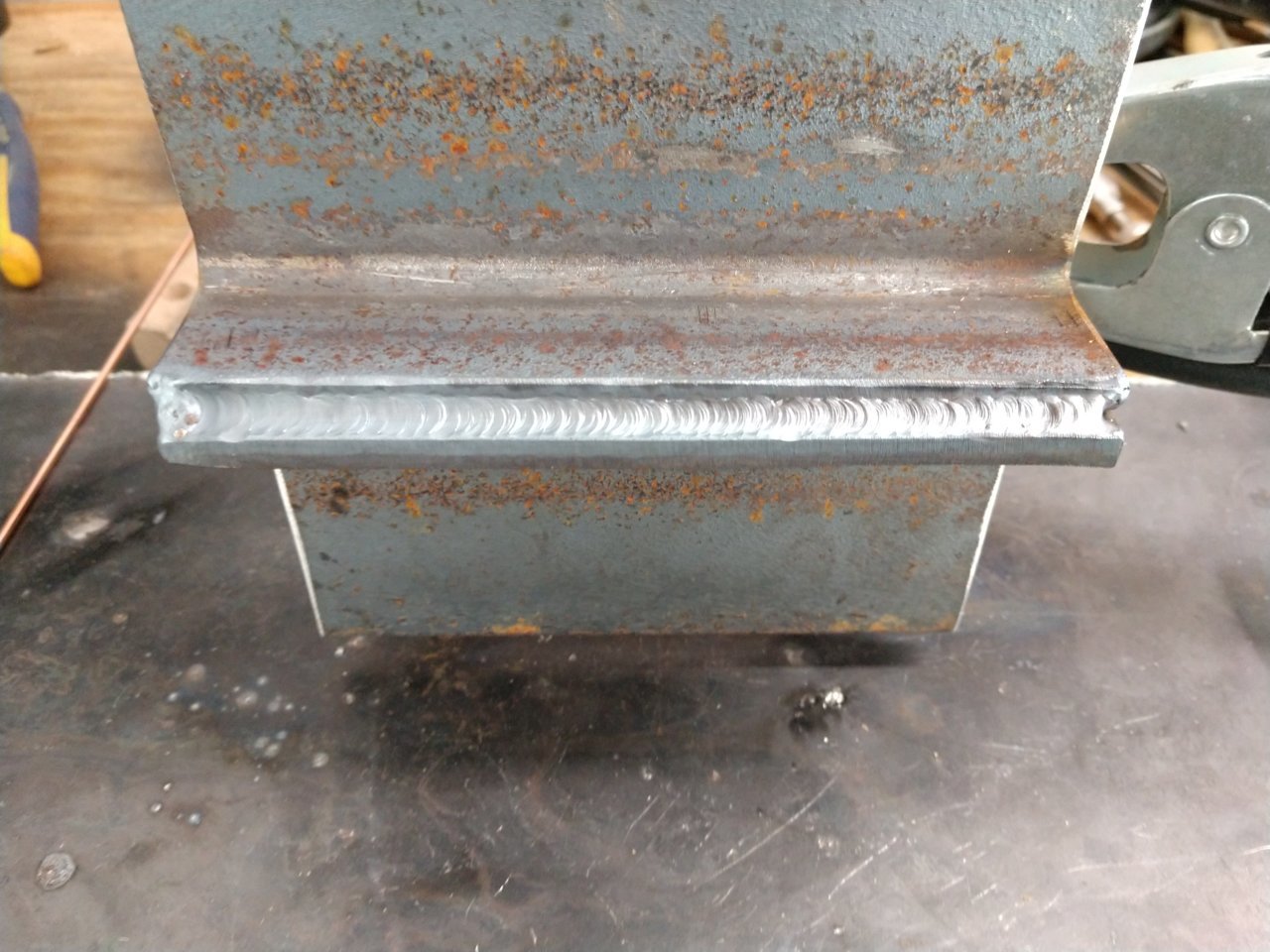

    Fired up my scratch-start Tig welding rig and went to work. IMG_20200502_121220896.jpg

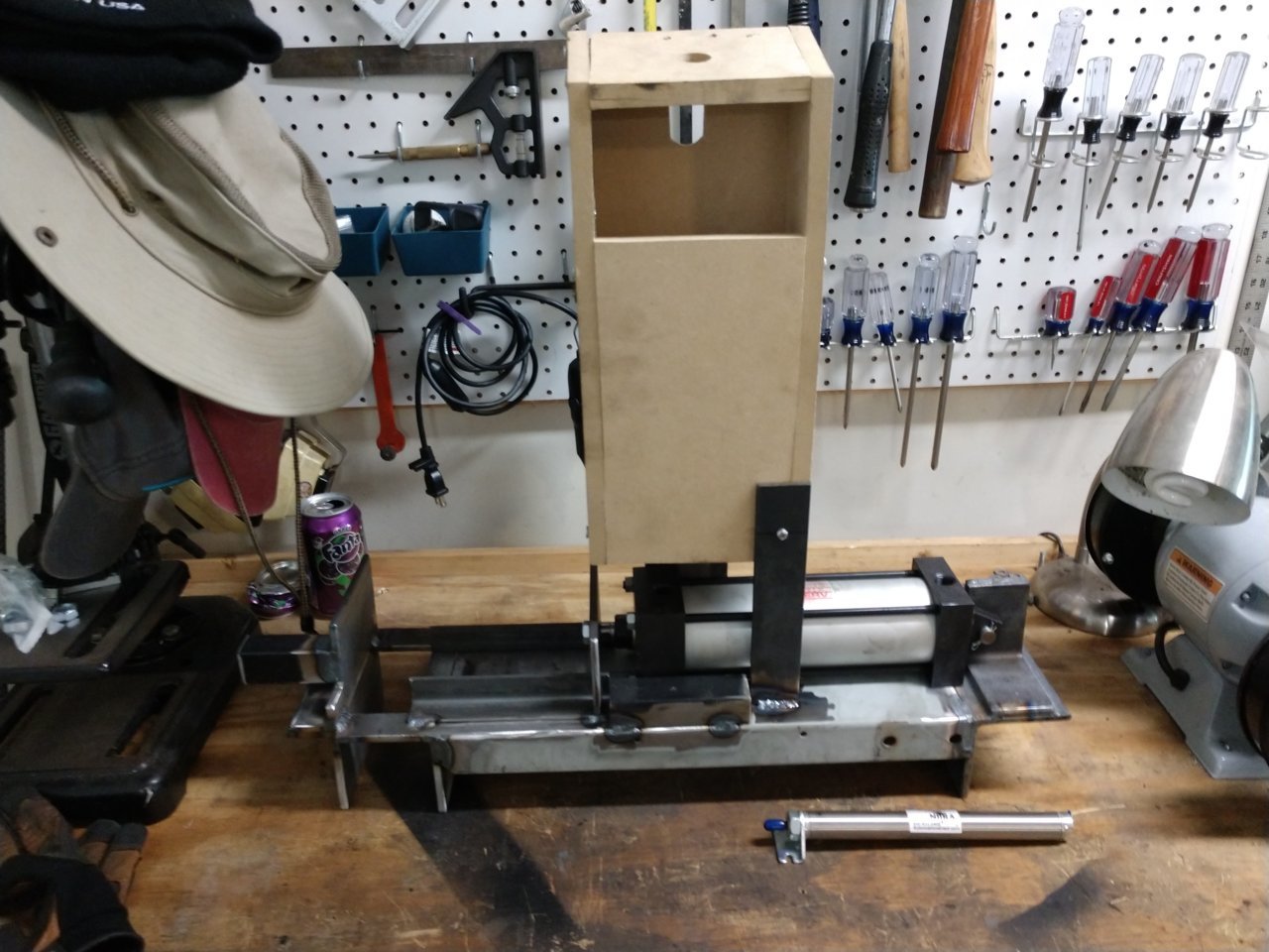

    A mock up of what I was planning by using a hopper I had made last fall for a completely different feed setup. I switched from a side mounted hopper to a top mount just so nothing is hanging off that may potentially break.
    After I got that far I needed to build a feed hopper that reliably positioned the can sideways in the crush tray. That proved very annoying. I spent the better part of a day testing different designs before I arrived at something that worked.

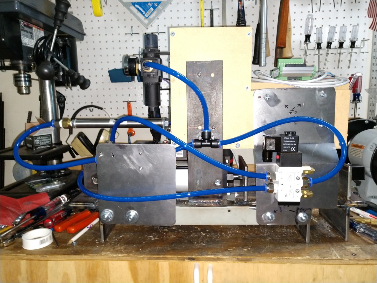

    Now that I had the basic functionality down it was time to automate it. I ran air lines from my regulator to a splitter then into each solenoid and out to the two pneumatic cylinders. (The second solenoid is behind the left hand steel plate).
    Then came wiring the solenoids and limit switches into the panel. I was originally gonna just hard wire everything straight to the box, but for the sake of easy transportation this wouldve been stupid. So after some digging online I found the answer to my issue. The Ziplink from Automation Direct. Simply wire the field I/O to the terminal blocks and it slims it all down into one cable+connector that can be unplugged from the board.
    On the other end its as simple as tracing out what's what and wiring things where they need to go.

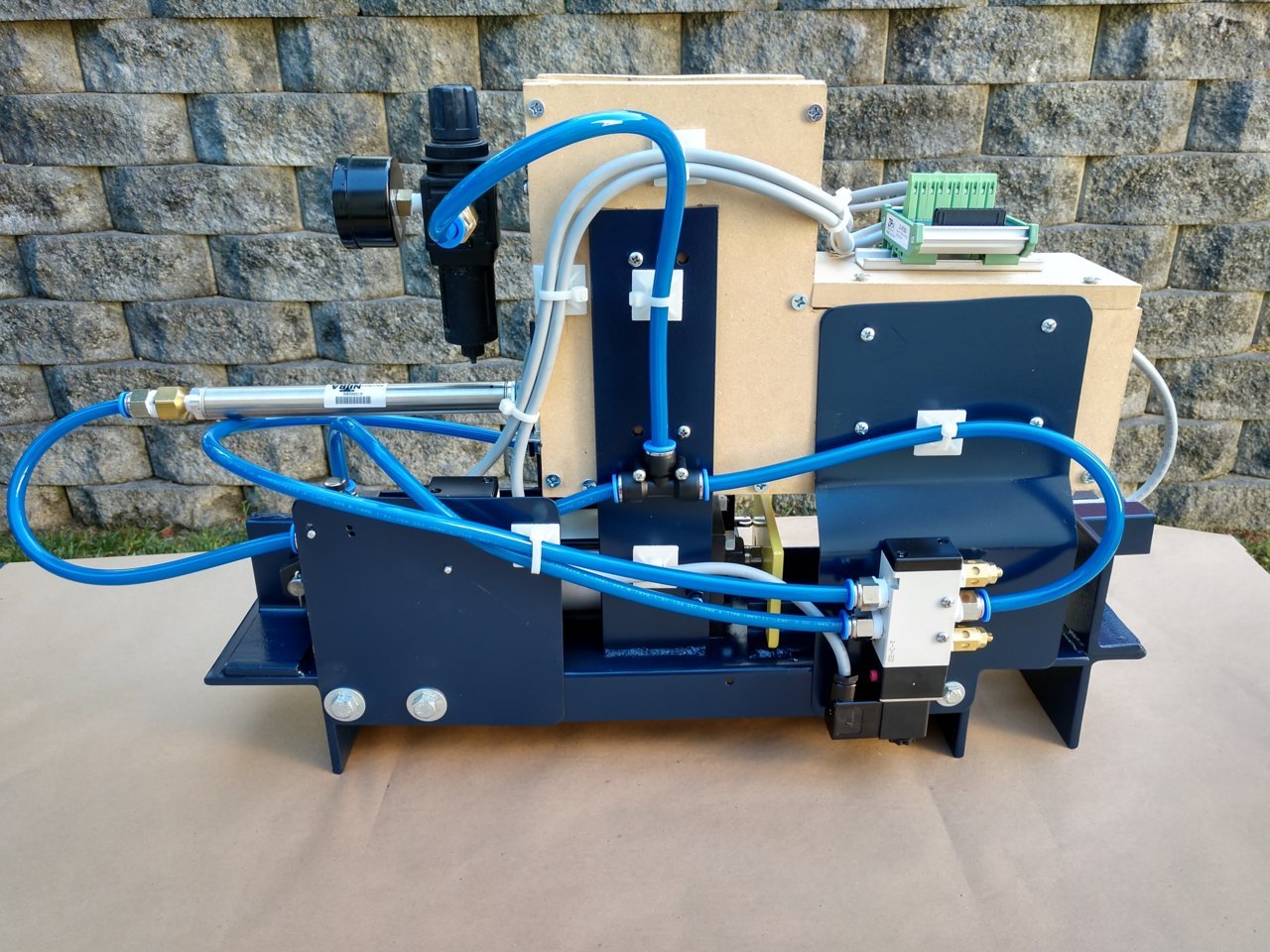

    Finally got around to tearing it down and shooting some paint on it. Also added one of the decals @BartMaster1234 sent me, along with making everything neat with some zip ties.
