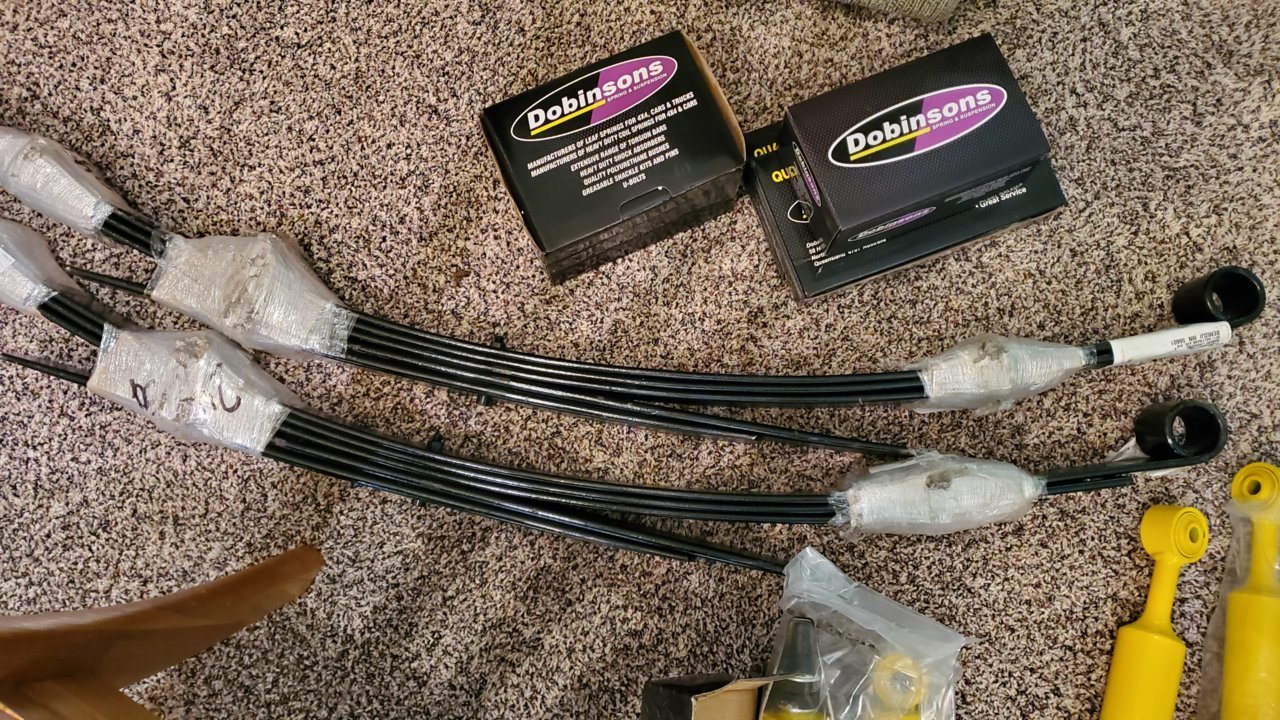

    I have some sitting on the living room floor. They're going to be installed Wednesday with the rest of the Dobinsons suspension stuff I bought. They say they'll give me a nice 2.1" lift in the back. It all looks really solid and I can't wait for next week.
    ALwoodsman[OP] likes this.

    I'll definitely try to remember to post in here when I get em on. I hit all the new parts with Shark Hide. You spray it on metals and it's supposed to ward off corrosion and rust. I guess it's used on boats, etc. Who knows, can't hurt I don't think.

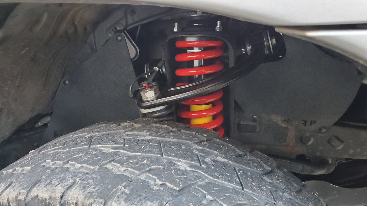

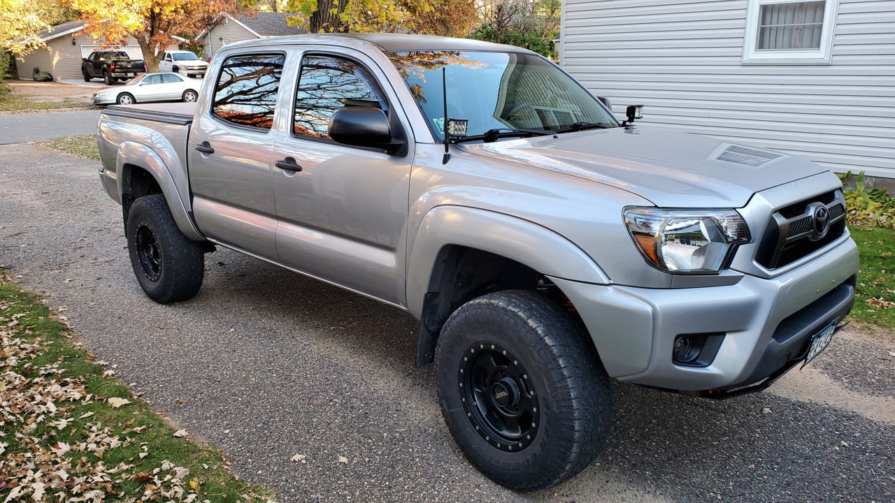

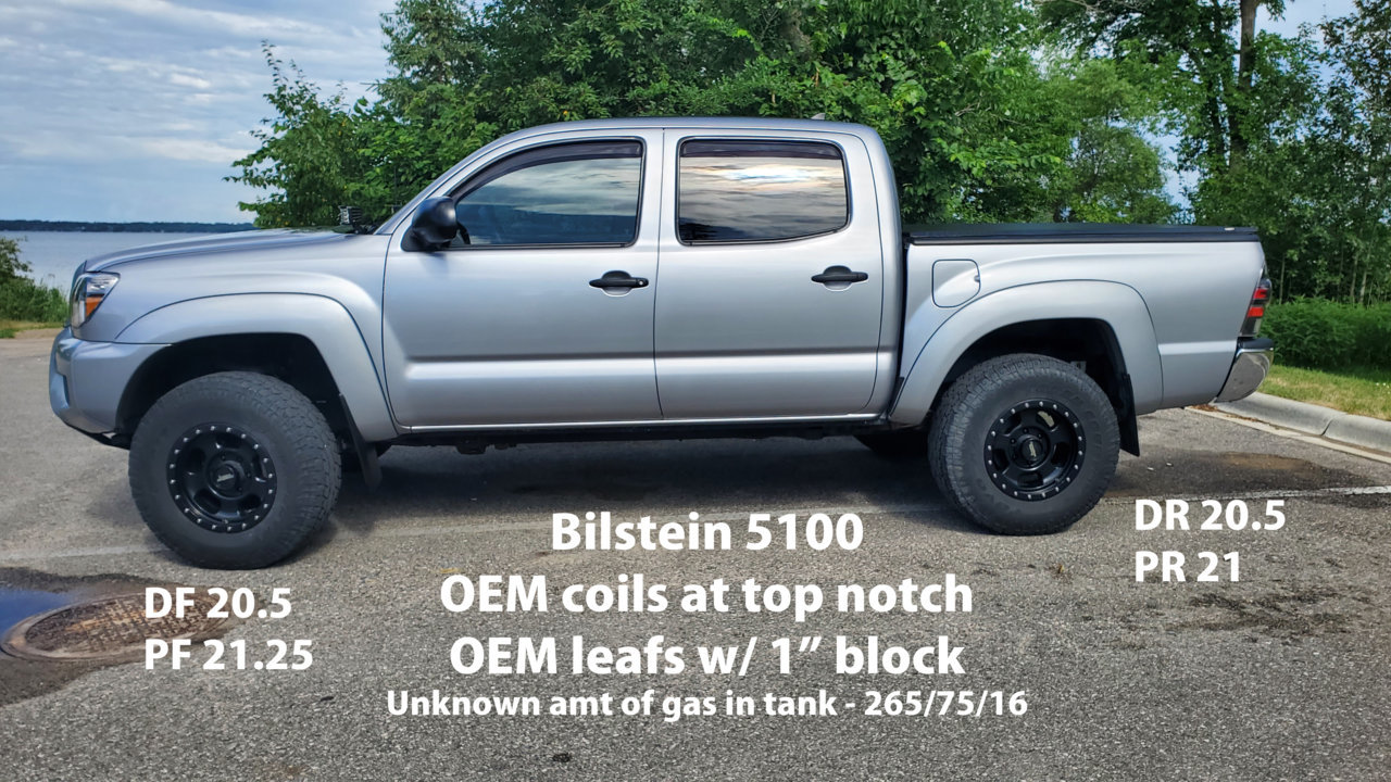

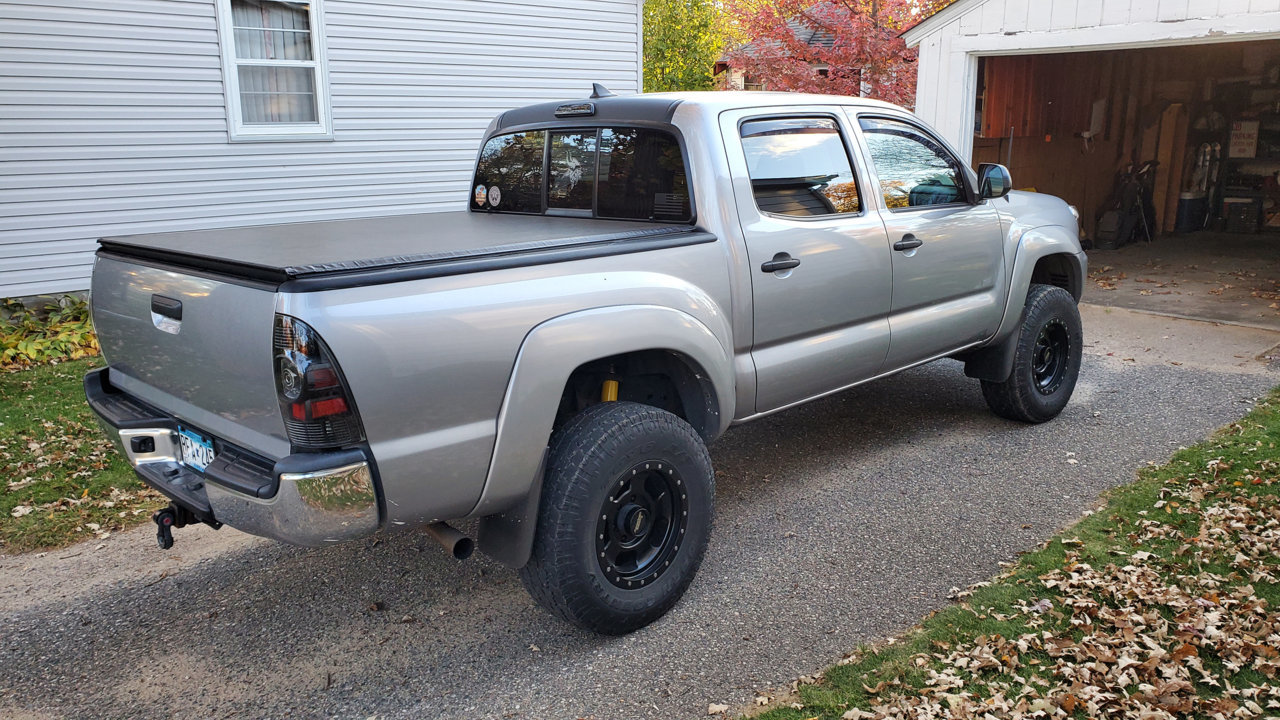

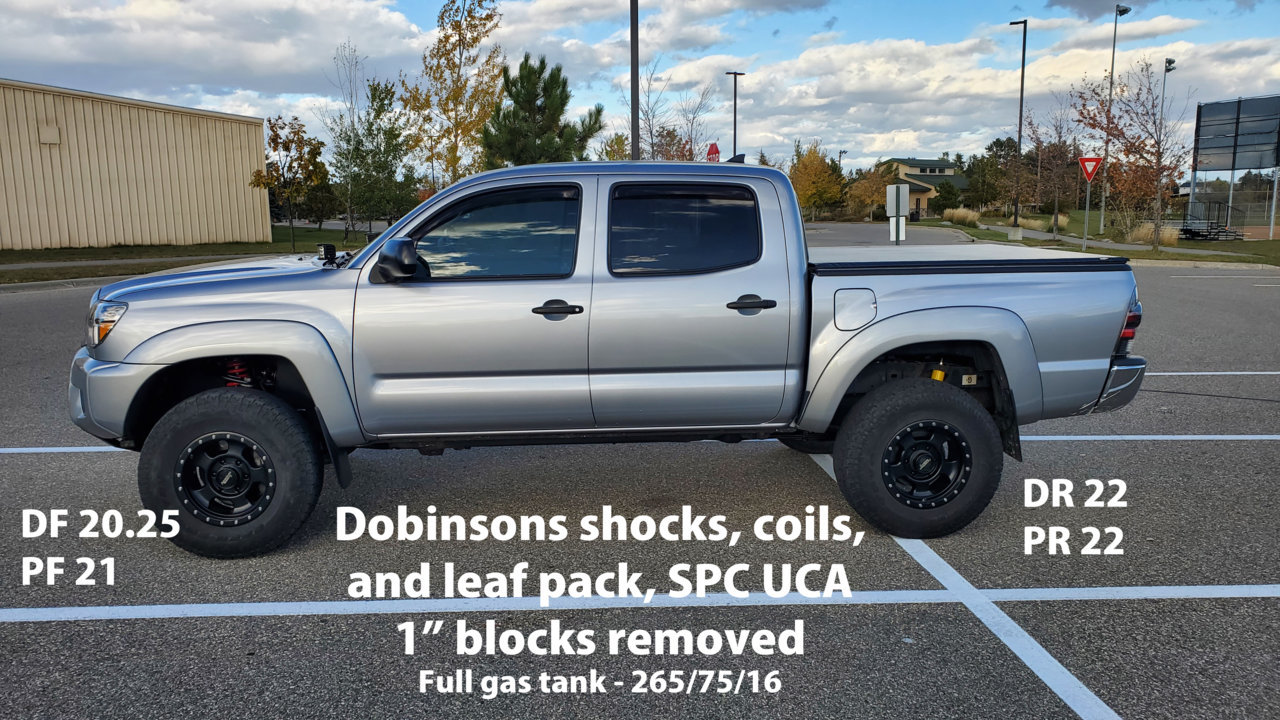

    Measurements from the top of the center cap. I got the taco lean spacer but it's still .75" lower on the driver side. I looked and the spacer is on the driver side, isn't that where it goes? :anonymous: So not sure what's up there, maybe gas tank? It's a more comfortable ride that before so I'm happy about that, and I like the stance a lot better.
    Leaf pack seems nice and no squeaking.
    BEFORE
    AFTER

    Thanks. Looks good. You are right the spacer goes on the driver side. Which leaf pack and coil did you go with? Did you get the height that you expected?
  11. Oct 7, 2020 at 6:03 PM
    Minny Taco

    C59-301 coils for 1.6"
    GS59-220 extended length struts for +1"
    L59-110-R leaf pack for 2.1"
    I was hoping for another inch in the back and got that just right. Front stayed about the same as my 5100s.
