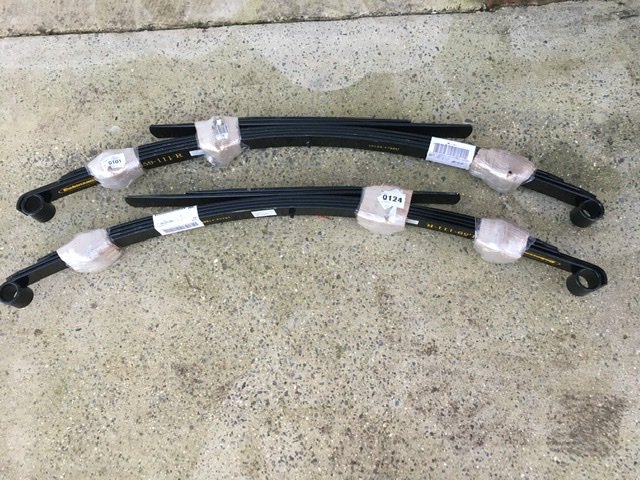

    9437A6AB-7199-49F5-9893-4FB64FE46121.jpg I ordered a set of 111s from Exit Offroad on Sunday and they showed up today! I don’t think I will get them installed that quick. LOL . Maybe I will get time to before the end of the year.
