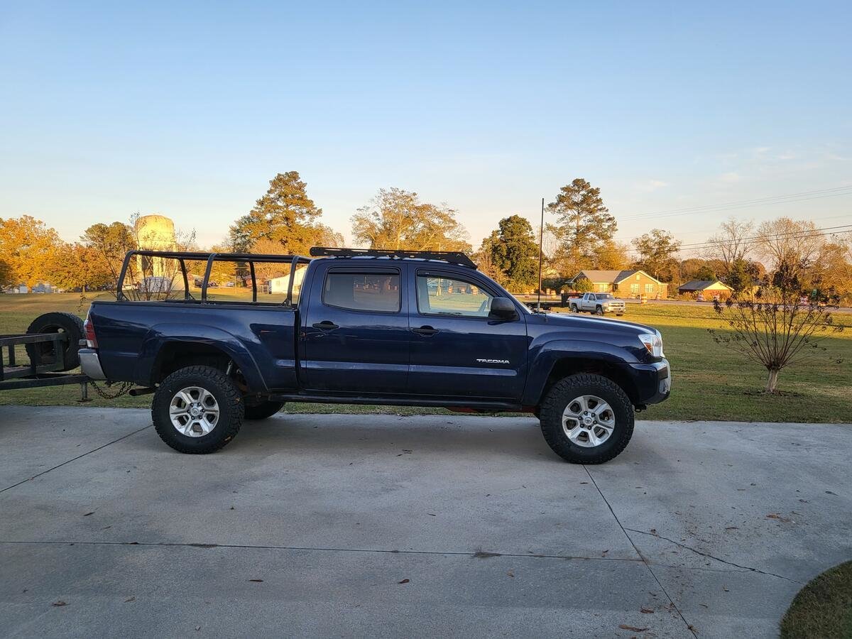

  18. Apr 20, 2022 at 7:21 AM
    #58
    ALwoodsman
    ALwoodsman [OP] Well-Known Member
    Sep 28, 2012
    #87902
    48
    North Alabama
    2013 4x4 DCSB
    Baja Utility Rack, SOS Concepts sliders, Bilstien 5100, OME 884, Toytec AAL
    I have a 2013 DCSB with a camper, sliders and rear steel bumper. With the 111's it rides great loaded or unloaded. I've had them for a while now and have been very happy.

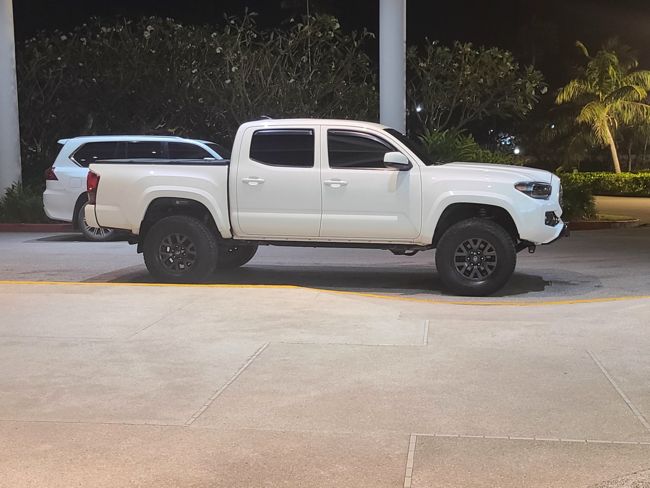

  19. Feb 17, 2023 at 2:30 AM
    #59
    Chief_CNMI
    Chief_CNMI Well-Known Member
    Sep 27, 2020
    #342052
    172
    Bryan
    Saipan, Northern Mariana Islands
    2020 4x4 V6 SR5 White
    All lighting are led, wheels, tires, 5100 lift, pro grill, bed light, seat covers, door sill protectors.
    Sorry, I know this is a old thread. But which model dobinson is great for the 3rd gen? I don't really have much weight. Only then I have in the bed are bed mat and oem bed cover and that's about it. 80% on road and 20% offroad. I'd like to have about 2.50" of lift in the rear without the ride being too firm. Eventually I'll get sliders too and that'd about it. I got the eibach stage 2 kit on my truck along with a single aal.
  20. Feb 17, 2023 at 5:21 AM
    #60
    Crikeymike
    Crikeymike ExitOffroad.com Vendor
    Oct 17, 2016
    #199985
    2,079
    Jax Beach, Florida
    The L59-110-R would do it for you. They're about 2.25" with the light amount of weight you have. Sliders won't really affect the rear lift height.
    Here's the link to them
    https://exitoffroad.com/product/dob...air-for-toyota-tacoma-2005-to-2019-l59-110-r/
