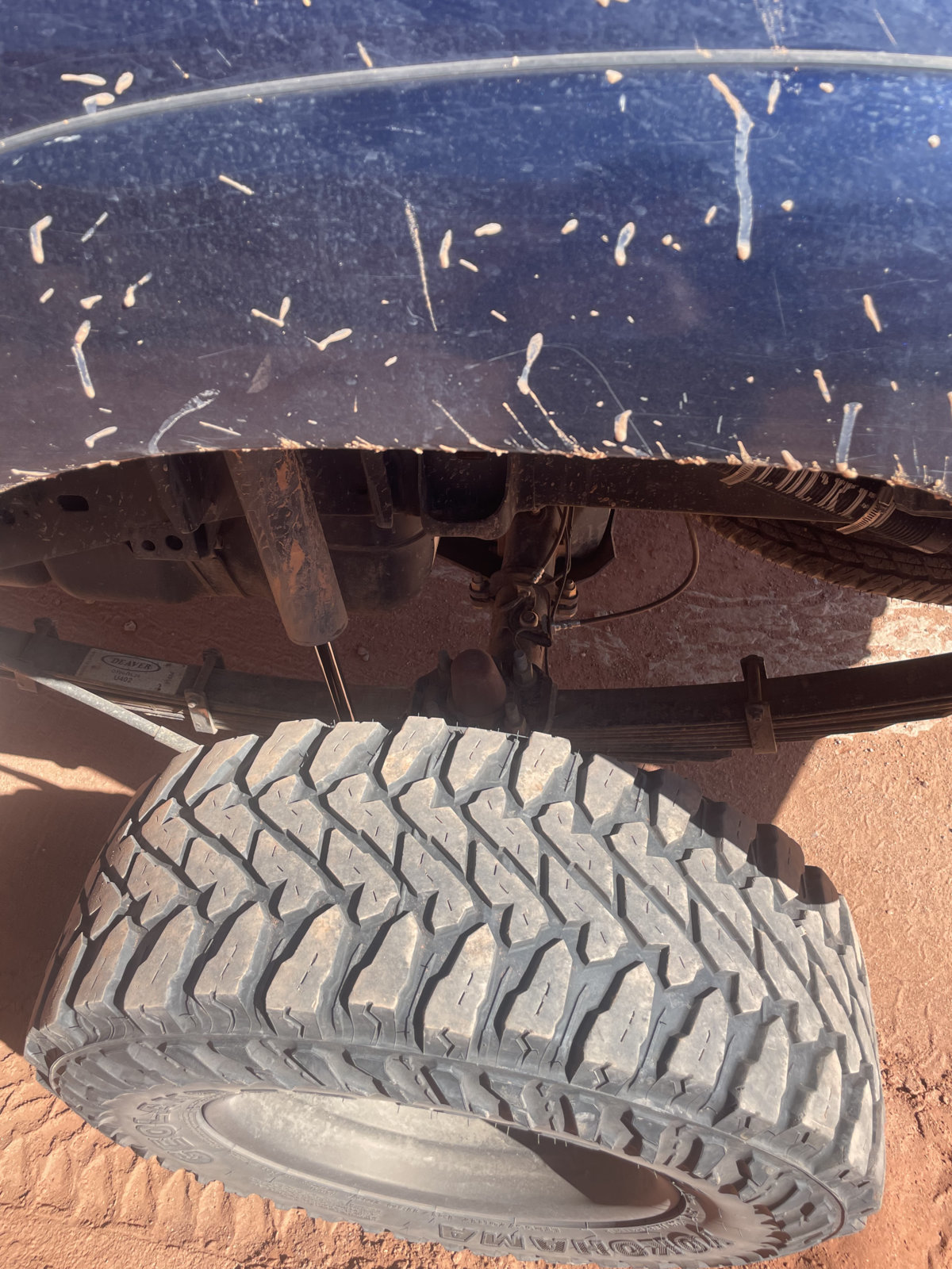

    I've changed up my truck a bit. No longer running the decked/camper shell. Also have Kenda 33x10.5's. I set my IMS's at stock height, so they need a slight adjustment to lift the front just a tad.
    Also running Dobinsons on the trailer :rofl:
