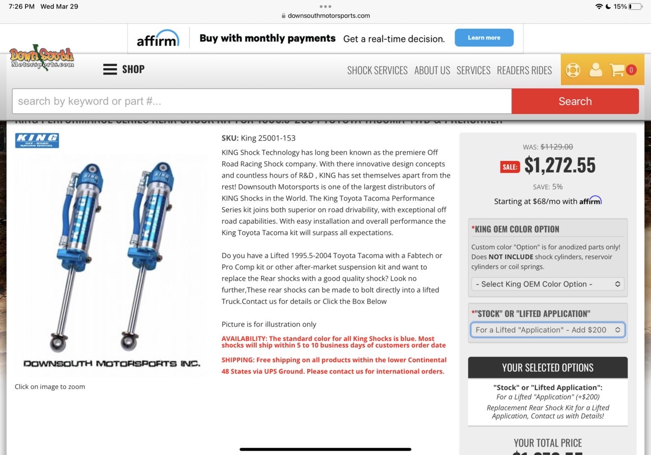

    So paying 200 extra option for a lifted truck is the same shock? And will still have problems
  9. Mar 29, 2023 at 6:53 PM
    Kwikvette
    Feb 27, 2019
    #284735
    80,016
    Fresno County
    4 run, 2 don't
    They have always had the same part numbers for 1st Gen Tacoma's and they have always been 'advertised' as being for lifted applications.
    The difference between one and the other were the addition of the 'adjusters' on the reservoir.
    Feel free to just call King themselves and ask them. It'd just give you a direct answer.

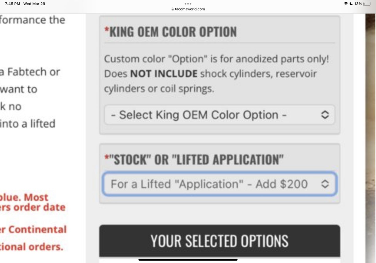

    Yes I saw that but down south shows an option for 200 for a lifted application and didn’t know if that was a different shock.
    I would not try to put on a 0-1.5 stock because it will not work,
    I will call tomorrow
