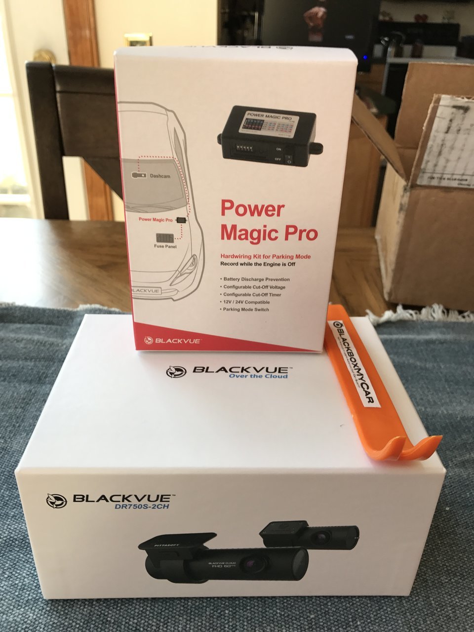

    @USDashCamera since I have no idea what I'm doing with electricity - for the add a fuses, if I pull a fuse, drop that in the lower slot of the fuse tap? New fuse goes in the top, and does orientation matter at any point?
    Any tips as to where to run the rear camera wire (right now I'm thinking drivers side, behind weatherstripping and plastic pieces on the top side), and has anyone verified constant/accessory power fuse slots on a 3rd Gen yet? I'm using a Power magic Pro

    The original fuse goes into the lower slot, the new top fuse slot is for the dash cam, so a 3-5 amp fuse is adequate. I actually wired my constant power straight to my battery because I put an aux fuse box under the driver seat so i can hook up multiple cameras easily for my reviews. But as 1bad2k said, the dome light should work as that is possible to turn on even when the truck is turned off.

    Blackbox my car sent 20amp fuses with the fuse taps. Am I better off replacing them with a lower amperage then? I saw somewhere that the top new fuse should be lower than the original, is that accurate?
    I'm looking to tap into the dome for constant, and will probably use a power outlet for the acc.

    https://www.blackboxmycar.com/blogs/news/how-to-use-an-add-a-fuse-kit
    according to their site 2-3 amp fuses are ok if you are just using a regular dashcam, but 7.5-10 if you are using a cellink battery. not sure why they sent a 20 amp.

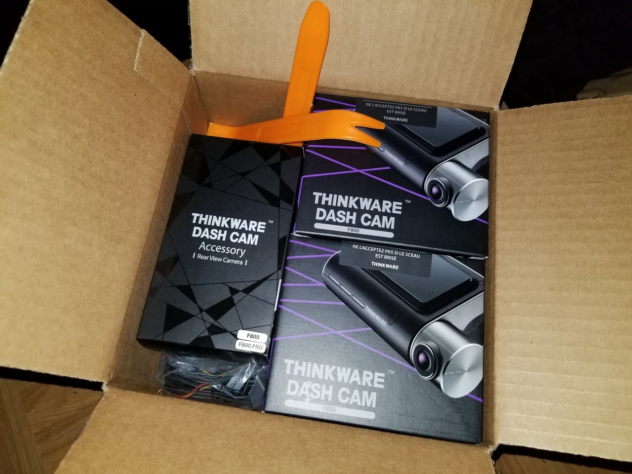

    Finally got the goodies, hopefully I'll get to install it this weekend.

    I finally got the new camera...installation this weekend
