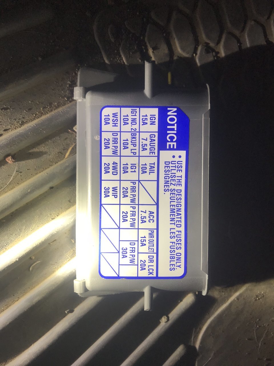

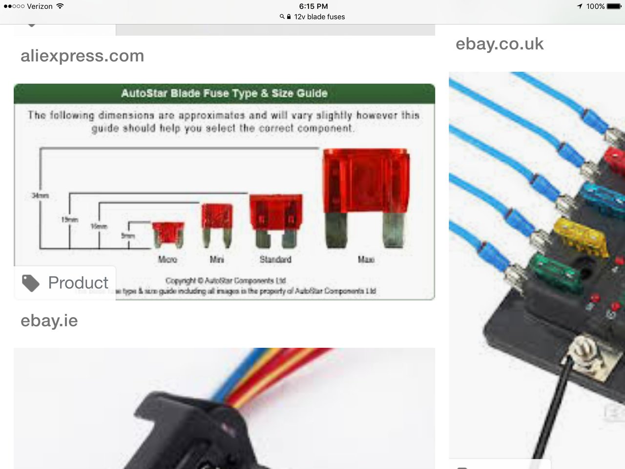

    Here is some info for those that might not have much electrical experience. In this pic, the micro is the factory size fuse in our trucks. The mini, is a direct replacement and will work in both fuse blocks, under hood and dash. The only difference between the 2, is the mini has the longer legs. The mini size is what I keep spares of.
    If you don't have a volt meter, here is a pic showing orientation of fuse. The red mini is 10a, which is the direct replacement for the removed 10a micro fuse. Pic is dark, but notice the 10a is placed toward the legs of the tap. The Lt purple fuse is 3a and used for the cam. Notice it is to the outside of the fuse tap legs. With these taps, if you blow the 3a, the camera will lose power but the factory circuit will still work. If the factory 10a blows, neither the cam or factory circuit will work. That is why the orientation is important. A 3a will blow too easily for the whole circuit and 10a is way too much for the cam. Remember that a fuse is designed to be the weak link. 10a for the cam word either make the camera itself, or the cam wiring from factory the weak link. Best case in a bad situation is your cam is ruined. Worst case in bad situation is wiring catches fire and burns a truck. I experienced a dash fire 30 years ago in my first 4x4 when I was in HS. It was caused by a prior owners improper wiring and I have been anal about wiring since. All the taps I have seen, have had a decent quality butt connector so I have used them instead of soldiering. When I do solder a connection I alway use a butt connector also, but I use the kind that have no plastic coating on them. You can easily remove the plastic from a connector with small dikes or a razor knife if needed but be careful as I'm sure a missing pinky finger would hurt. I alway use heat shrink on every connection. If a non soldered connection is used (plastic on BC) I use 1 layer of heat shrink, but 2 layers on soldered connection. Vehicles vibrate and get bounced around so it is simply added protection from chaffing. On double HS connections, cut 2 pieces of HS, and install over the wire. Place 1 at connection and heat with the other moved away from heat. After the first is done, then slide the second HS over and heat.
    As I stated, I am anal about electrical but for good reason with personal experience and I have seen vehicles burnt to the ground including a log truck.
    This last one shows fuse placement in dash on my 14. If possible, always use a voltmeter to find your switched or constant sourced power.
    I used WSH 10a for switched(power with key)(acc. power)
    I used POWER OUTLET 15a for constant.
    The taps I have seen have been factory recommended 10a. The tap can and will handle 15a safely. Like with a tow strap, they might be rated for 5k lbs, but have been tested to 8k or even 10 k before breaking. It is a built in safety margin.
    EDIT: at my local parts store they sell 10a, I looked online and see they do in fact sell higher rated ones, but without having one to find out what size wire is used, they may just be the same thing from a different manufacturer.
    A voltmeter (multimeter) is something everyone should own. You can get a cheap one from harbor freight for less than $5. Get one, watch some YouTube vids, and go test your wall plugs in the house. Test your battery while off, and running. That will show you how much voltage your alternator is putting out. Learn how to use the ohm function to test fuses without having to pull them. I have schooling for electronic/electrical but there is a bunch of basic stuff you can learn on your own which could save you mechanic/ install money or your truck/ home in a bad situation.
    Hope this info can help some out. I have learned a bunch from this site, and want to give back with my knowledge and experience when I can.
