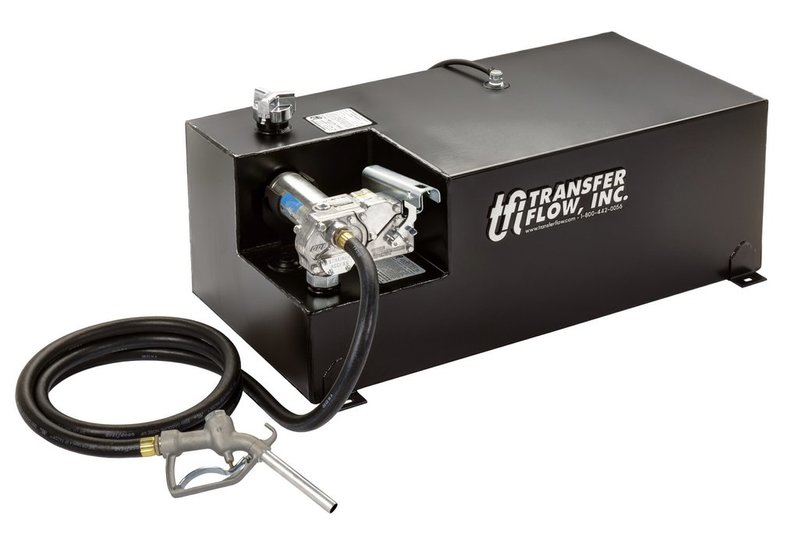

    image.jpg The dimensions will vary depending on the design. If we just take 1st gen Tacoma and place a 20 gallon tank between the wheel wells of a double cab, The tank would be 37"L x 10" W x 13" H.
    That will make it 4,810in^3
    The volume of one gallon is 231in^3
    Therefore that would make the tanks volume, 20.8gal
    Vapor space needs to be considered as well, which should be 10%.
    I'm thinking of something like this tank above, but not the final design. I have some different design ideas with the constraints we have on a small pickup.
