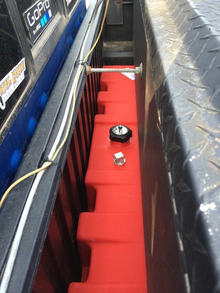

    I've had great success with the aux tank setup I put together, I use a 15 gallon marine tank (holds closer to 16 gallons when completely full) that I keep under the tool box in the bed. Great size, because if you don't count the fuel you have left once the empty light goes on, you are essentially doubling your range. I tied it into the stock filler neck, and can transfer fuel into the stock tank on the fly, with dual fuel pumps that I can turn on from the cab. While bizarre, it's very convenient to watch your fuel gauge raise as you drive down the highway.
    You can get the tank on Amazon for about $150. the means of fuel transfer and price of the rest of the needed parts are really up to you. I have about $200-$250 into the entire setup.

    How about the risk of fire, do to the plastic bed lining in our trucks?

    ground the tank, and it's no different than the tank sitting below the bed.

    How do you ground a plastic tank?

    ground the metal components on the top end of the tank. there's a metal fitting that goes into the tank, to the metal suction tube that sticks down to the bottom of the tank. other than that, it's just making sure the fuel pumps are set up properly, with adequate wire gauge running them, and the correct size fuse.
