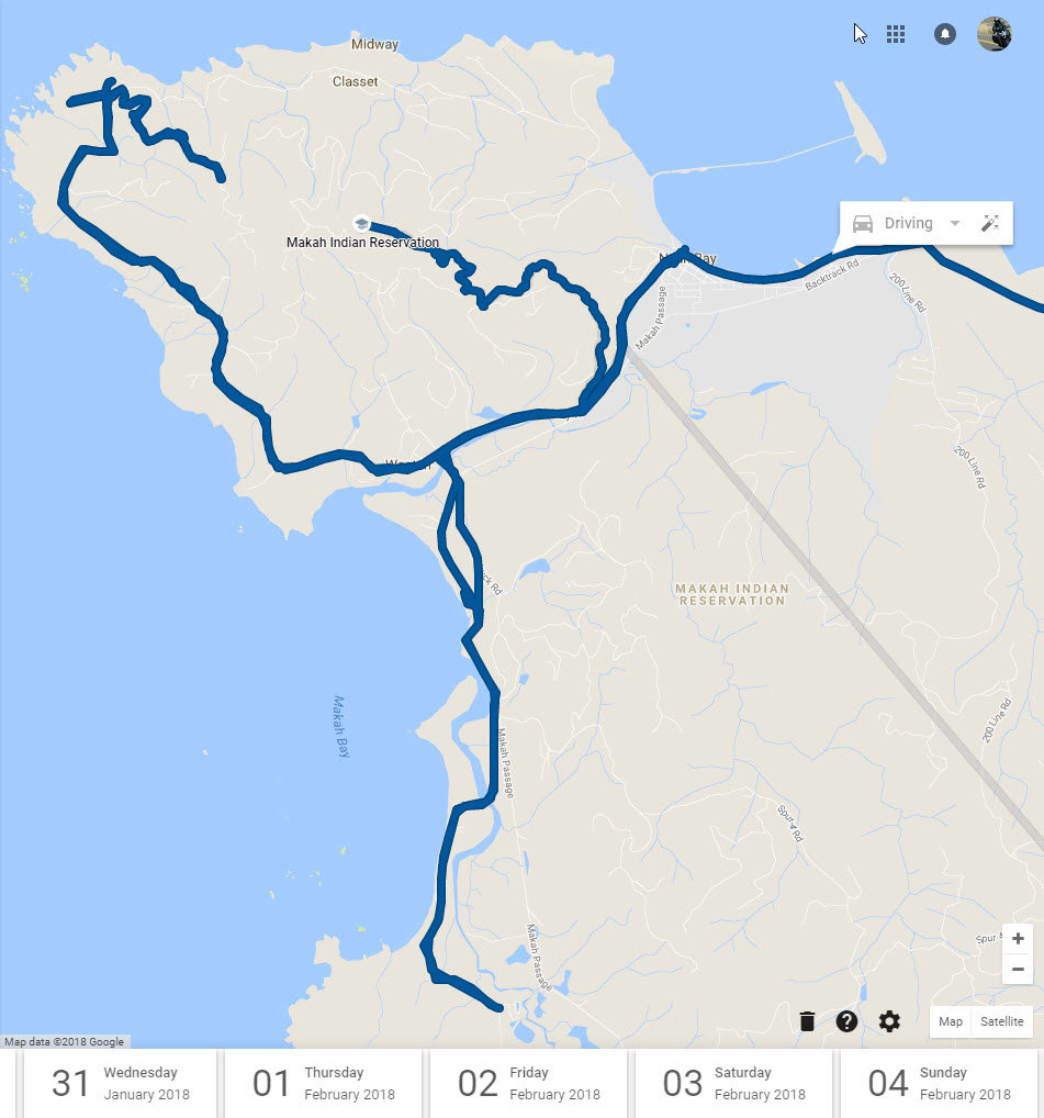

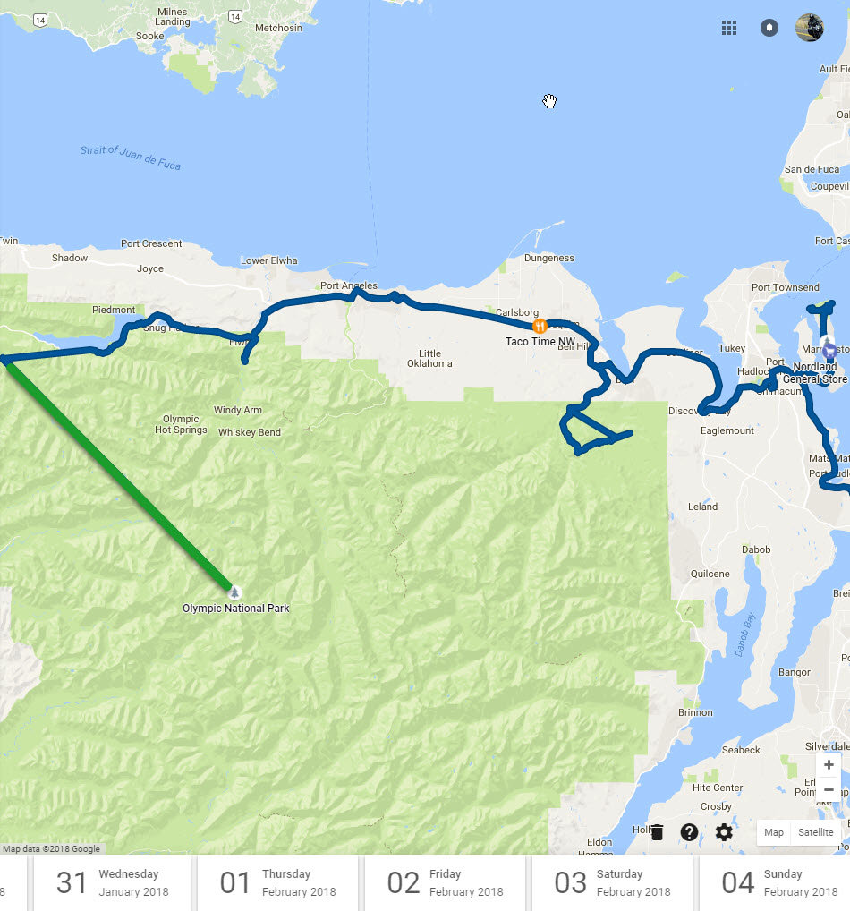

    I only have a tonneau, but the trip that I just took had the whole WA coast blowing at me sideways with both gusts and high steady winds. It was not an issue.
    Funny guy! That curb is a daily frustration, for our cars / motorcycles also. It is just an example of what folks could try with or without.
    I pulled the sway bar off in anticipation of being out solo for three out of five days:
    https://www.tacomaworld.com/threads/hondo-garages-new-thing.516490/page-63#post-17202726
    I would have been unhappy getting around the NW tip of WA with the sway bar on:
    I'm not sure what was up with that green track. I didn't get in that far.
    Most of those tracks are on road, but the sway bar being gone made the off road stuff much better.
