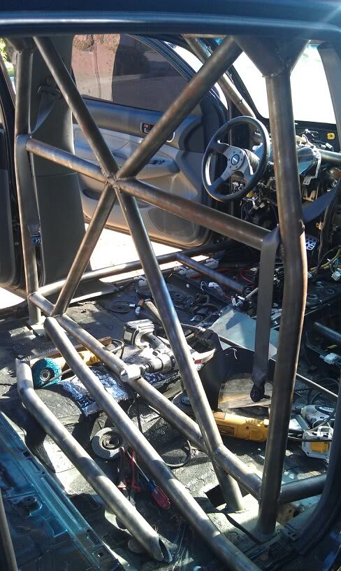

    I'd definitely be interested in a Weld-in or Bolt-in kit.
    - DOM or Chromoly!
    - Access Cab Availability
    - Ability to keep:
    - stock dash in-tacked (cutting is acceptable)
    - stock headliner
    - stock floor carpet
    - Cross beam between A-Pillar Tubes to be on closer to the windshield (kind of out of sight)
    - Additional Gusset Kit (see pictures of Mike's Cage)
    - Windshield bars (see 3rd Picture down)
    Mixture of these:
    Mike's (mjp2) cage would probably be the easiest to copy for a WIY kit or a Bolt-On kit

    Would love to retain backseat capability (whether stock or race seats) in a double cab. Tie the cage into the frame through the floor of the cab; maybe with some bushings thrown in to account for cab flex (so the cage doesn't tear the cab apart).
    DOM tubing. Most garage fabricators can't weld chromoly anyways.
    Let the end user figure out seat mounting; with everyone running different seats and some people doing things in stages it would be best that way. Bending a few tubes to make cage-mounted seat brackets is very reasonable.
    Weld in is the way to go. Anyone with a legitimate need (pro's outweighing the cons) will benefit from the cost reduction of a weld in.

    my access cab cage is around 220 pounds in tube

    What's you cage made out of?! and How many mounting points does it have?!

    1.75" .120wall dom with 6 attachment points to the chassis.
    fyi... 4130 tube isnt any lighter than the dom/mild equivalent. so tube choice dosent make any difference besides strength and price.
