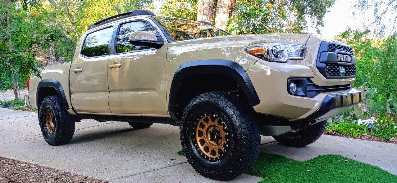

    KDMaxx tune K&N drop in AFE catback Oil catch can Bill's 6112/5160 Dynomat whole inside of cab TRD skid plate
