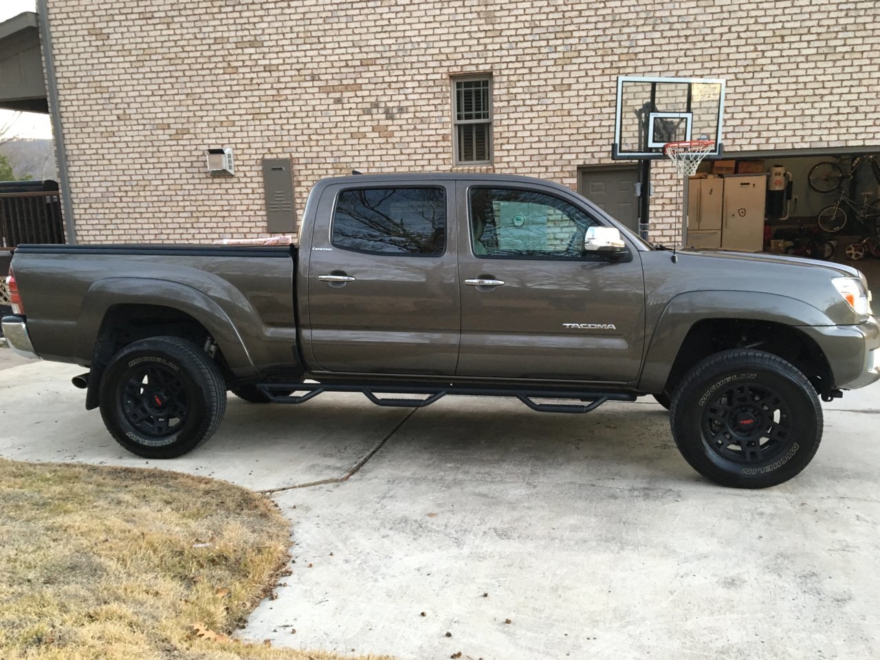

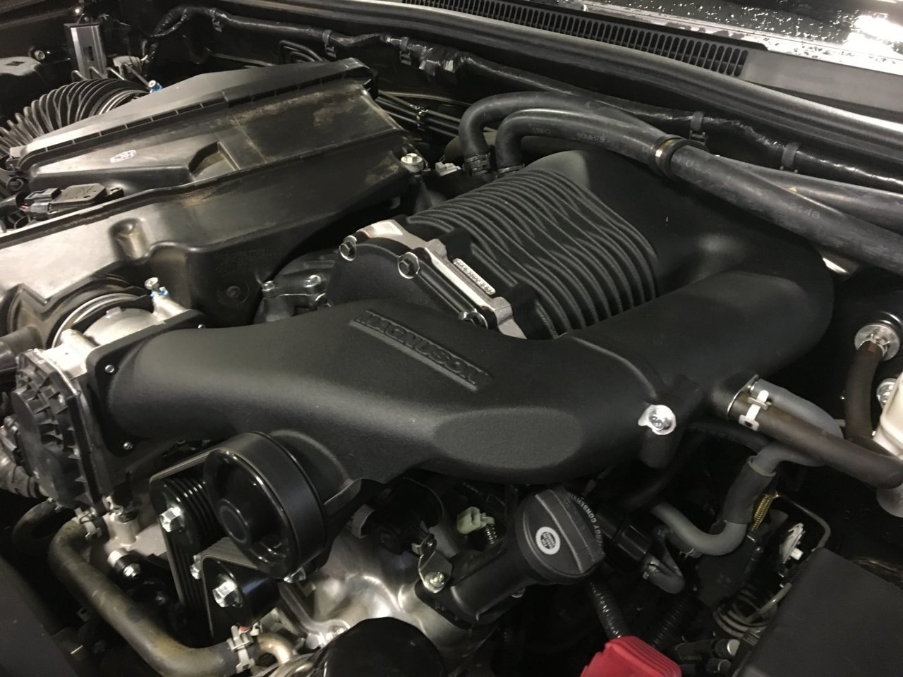

  14. May 11, 2020 at 6:39 PM
    rmepilot
    rmepilot Well-Known Member
    Jun 22, 2013
    #106798
    11,006
    Rob
    Huntsville, AL
    '23 LR DCSB TRD OR 4x4 Premium Pkg
    2019 Jeep GC Summit 5.7l '15 DCLB S/C 4x4 Limited Pyrite Mica - Deceased
    Before I put the TerraGrappler’s on.
    CEAC61A8-516F-4B7B-858E-8B54AC9EEE47.jpg 1C698CD1-B88C-4455-AA97-57D978407D3D.jpg
    Also before the headers and JFR custom y-pipe were installed too.
    It's too dark for a current pic.
