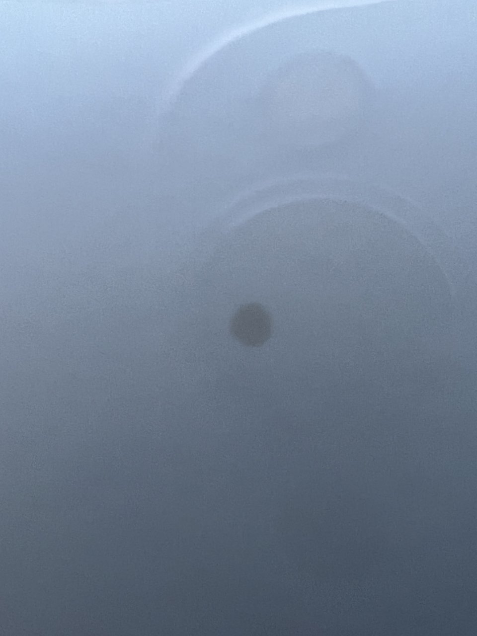

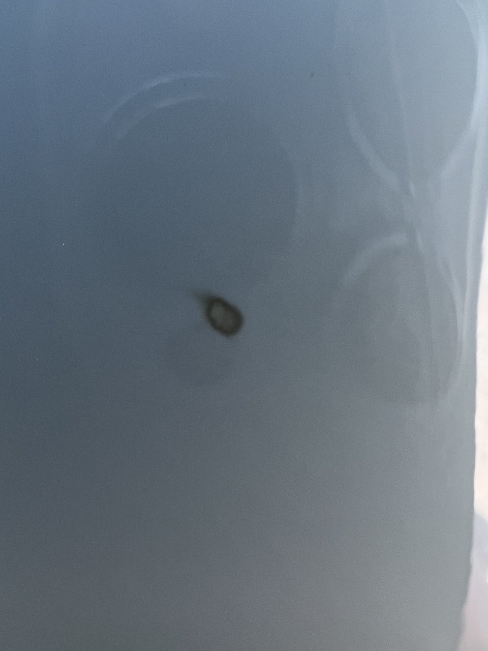

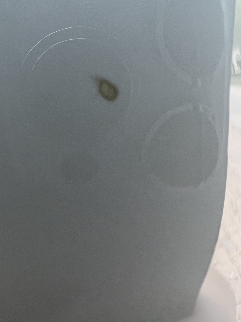

    I got the truck with 4 miles on it has 99 now. I might have missed these spots but I swear they are randomly popping up and I have barley drove it. Here are some pics let me know what you think? hoping their is not paint problems like the super white I have read about.

    0 issues on mine. What sort of spot is it? Is that dirt or did it eat through the clear ?

    Not just white, white is known for flaking off. There have been other colors that have had issues with rust, rail dust and other issues.

    That’s called a speck of dirt.

    thought was dirt but does not come off. I have maybe 6 spots all that size like that including under the paint protective film from the factory in random places. have to look real hard to find them.

    Someone else had an issue lately with spots under the PPF on a brand new truck. Not sure how it was resolved. This is gonna sound weird but it almost looks like a burn. Maybe try a clay bar on the other spots or yeah back to the dealer you go. Good luck.

    I already clayed polished and ceramic coated. as for the dealer I bought it out of state 1600 miles away.

    Can you run your fingers over any not under the paint protection? Any difference in feeling? I want to say they're some sorta dirt/contamination

    Did it look the same before you tried to clean it up or did it change (better or worse). Since it would be a warranty type repair, you could take it to your closest dealer. It's pretty small though, they might just look at you and say this guy is gonna be a pain in the butt. I would just keep an eye on them and maybe ask the service department at your first service.

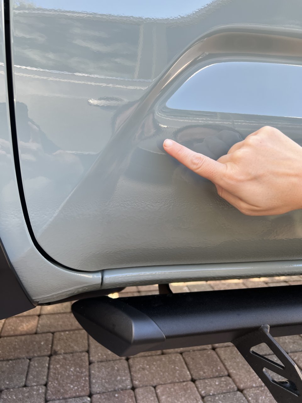

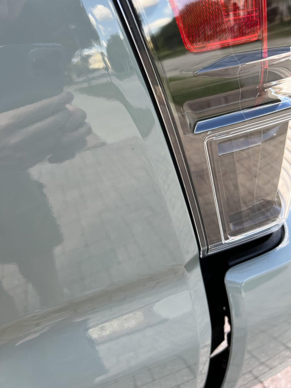

    It's weird it feelings like it is apart of the clear clear or etched in. its super smooth because I ceramic coated the whole truck. they are very hard to see.
    far and close up view from a different spot

    That looks like iron/rail dust. They make products to remove that stuff. Google fu.

    maybe use an iron remover like from adams polish?

    Rail dust is usually reddish/brown, rusty lookin. Cause it is.

    That'll probably work. I've seen it on a few customers cars before and iron remover will usually get most of it off. Much easier to get it off now then to wait and do it later on.
