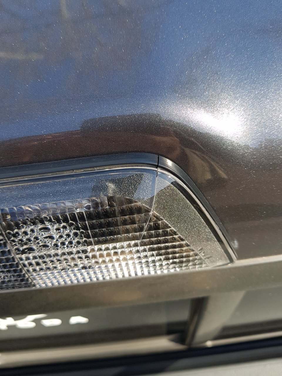

    Bottom line up front, has anyone encountered a leak at the shark fin, or has this always been at the brake light? Here's the long version:
    -A long distance trip is planned to start very soon.
    -A short trip (weekend) just ended. Upon washing the road crap off the truck & travel trailer, a leak was found (wet headliner, dead center, dripping on the center headrest).
    -A limb fell on the windshield last year, and the entire cab was repainted. The collision shop listed R&I for shark fin, but not the 3rd brake light, my guess is to bill hours to insurance. Truck is still under warranty, but I'm not sure what kind of runaround I may get from the local service centers because this issue could be caused by a 3rd party collision shop. I'm sure the collision shop can get this done, but I'm not sure I want to give them Tuesday to look at it, Wednesday to order it, maybe Thursday to install it... Keep in mind, this is not billable hours.
    -It's very possible (to avoid upsetting trip plans) I'll be buying the part out of pocket, and I want to limit this to one repair attempt. Has anyone heard or seen of a leak at shark fin? Any guess what the light assembly runs? Are these still on backorder?

    If the fin and/or cab light was touched from stock, that would be a good place to start. Somehow a lot of folks have had issues with it sealing after disturbing it in any way.
    Very good chance the repairs are the culprit.

    My 3rd brake like leaks a little bit... hit it with a kayak. Look close at your brake light for a split seam. My headliner doesn't get wet that I know of but some water is getting into the cabin.
    Got a good deal on replacement part from epay of all places.

    Mine leaked. Every thread I’ve read has the same story “it’s on backorder”. A few days later they have it in. So far, no more leak.
