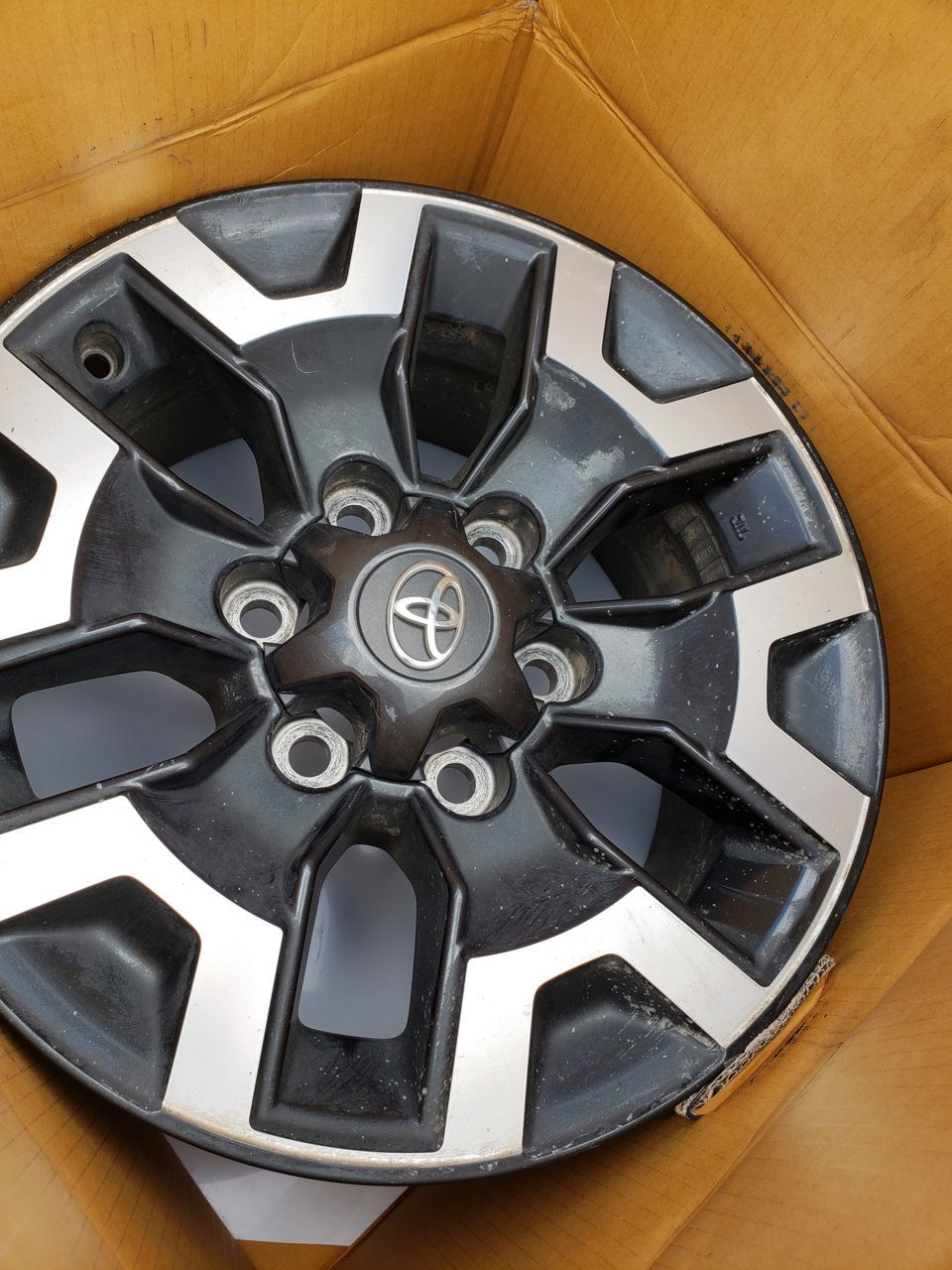

    Hello everyone,
    I am going to make a marketplace thread shortly but thought I would mention it first here to give Arkansas preference.
    I am selling 4 stock TRD Off Road wheels. Came off my Tacoma after 12,000 miles. I am asking $500 OBO. Shoot me a PM or respond. I am located in the Fayetteville area. I'll send more photos of the wheels.

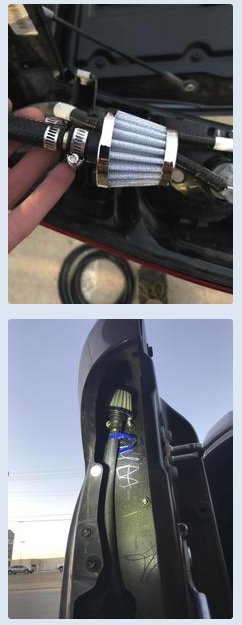

    @TenBeers I routed mine behind the driver side tail light housing. If you take the housing out, you'll see there's a hole in the plastic that is big enough for the hose to go through but not big enough for a the breather. All you need is a zip tie mount or two.
    As a side note, I had less than 10,000 miles on mine when I did this, and there was a definite pressure exchange when I loosened the OEM pop-off valve on the top of the rear diff.

    Mine sounded like a 2-liter coke opening when I loosened the valve fitting.
    Thats a good looking mod there, Crashman

    @CRASHMAN50 That does look good! Dang, I ordered a Toyota breather, but I like what you used better. I may have to pop by AutoZone and check out options like yours. I have to take the tail lights out to do the bed braces anyway, so I can just do both at the same time.

    I went the route I did just to keep the air free flowing. I think those little breathers are technically breathers for go-kart engine blocks? Something like that. They're like $11 each. You could raise that pop-off valve at the end of a line, but after long enough, it'd still build up a vacuum. It would just take longer since it'd have the line to build up pressure in too. I did the same thing to the front diff breather under the hood, but it didn't have much pressure built up because it comes from the factory with some line. But it has a real breather now, so that's future proofed.

    I used a lawn mower fuel filter from NAPA on front in engine compartment and a VW bug fuel filter on the rear. Both were less than 5 bucks.
    There are arguments both ways about replacing pressure valves with open 2 way fuel filters. My logic is like yours, it can inhale and exhale all it wants if it is higher than my engine air intake. They're made to protect axle seals from sudden positive and negative pressures primarily, secondly to keep water out of the fluids. The filter just keeps dust out of the diffs.

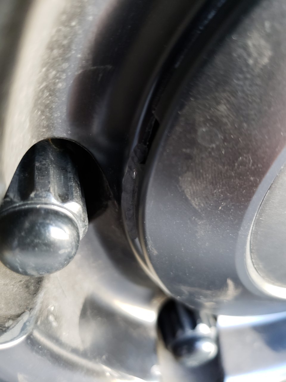

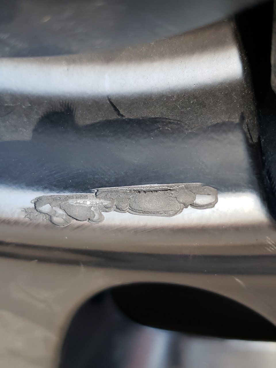

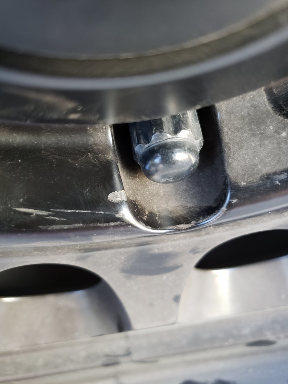

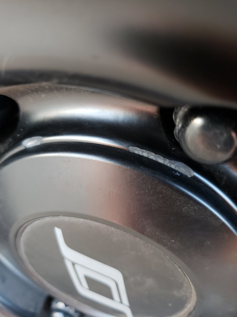

    I went to discount tire today in Fayetteville to get my wheels and tires balanced..... my SCS wheels are now scratched and torn up..... so sad and mad right now. They're sending someone out next week to see if they can repair them. Photos pending
