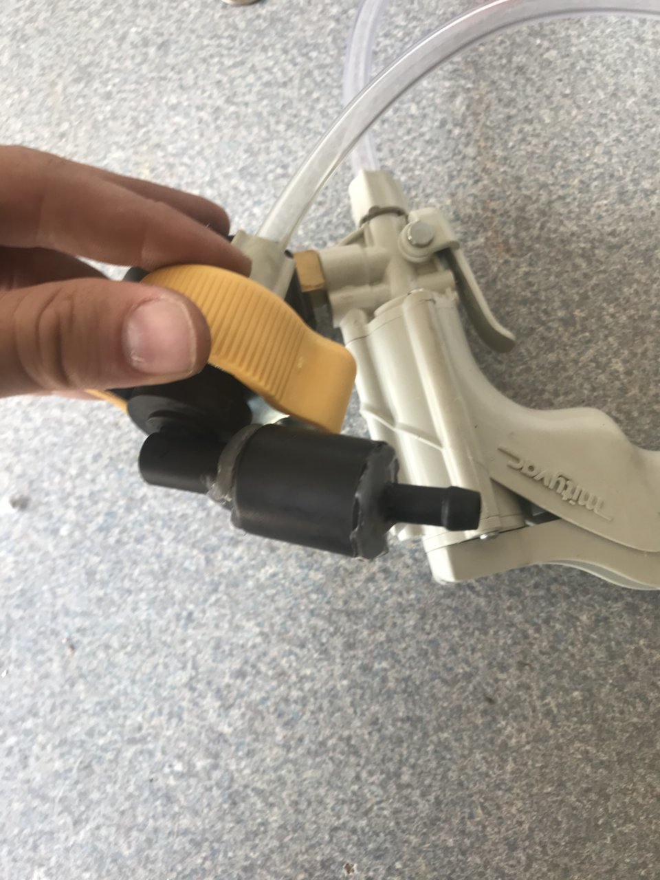

    Dave_M
    Dave_M Well-Known Member
    Apr 7, 2018
    #249767
    135
    Dave
    OR
    02 Tacoma
    I just rigged up a little jig to test the valve in both directions. Don’t judge me on how crude it is! It’ll hold 5 PSI when blocked off so it’s fine for this test.
    In the “out” direction flow was not restricted enough for me to measure it with a mityvac. In the “in” direction flow was blocked until .5-.7 PSI was achieved. Once the required pressure was observed, the valve continued to vent until pressure was equalized. I’d expect some threshold variance from valve to valve, but that should be about the same for all of them.

  16. Sep 7, 2018 at 10:43 AM
    #3576
    TenBeers
    TenBeers Well-Known Member
    Jun 5, 2009
    #18067
    7,701
    Rich
    Bentonville, AR
    2018 TRD Pro Cavalry Blue
    Yeah.
    LOL, I'm impressed that you actually set up a real experiment! BUT WHAT DOES IT ALL MEAN? :annoyed:
    I would have thought that the "in" direction would be open until a certain pressure was reached, and then it would close off. The behavior you describe is a bit different than I would expect, but it makes sense if trying to avoid being vented to incoming air unless absolutely necessary, and it should protect from water coming in through the seals.
    I have a brand new valve at home (the Tacoma one looks a bit different) and will run my own (much lower-tech) experiment before putting it on. You can probably guess how I will do it.
