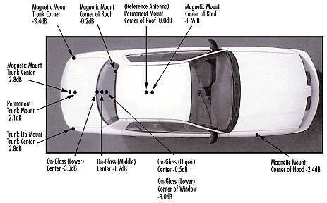

    I looked at some pictures, and some are mounting on swing out, or hood mounts. I could probably use my existing mounts on both vehicles, unsure yet, more research is needed. I am concerned about tight trails, but 30 mile range plus option of hitting a repeater is tempting. I do want a scanner option tho. and I bet those things get NOAA a long way away, where my CB doesn't get it in the mountains at all.

    Ground plane is a potential issue..."The minimum ground plane required should be ¼ wavelength in radius. At 462-467 MHz that’s about 6 inches", so would almost have to be hood or roof to get max.

    Another useful diagram when choosing an antenna location
