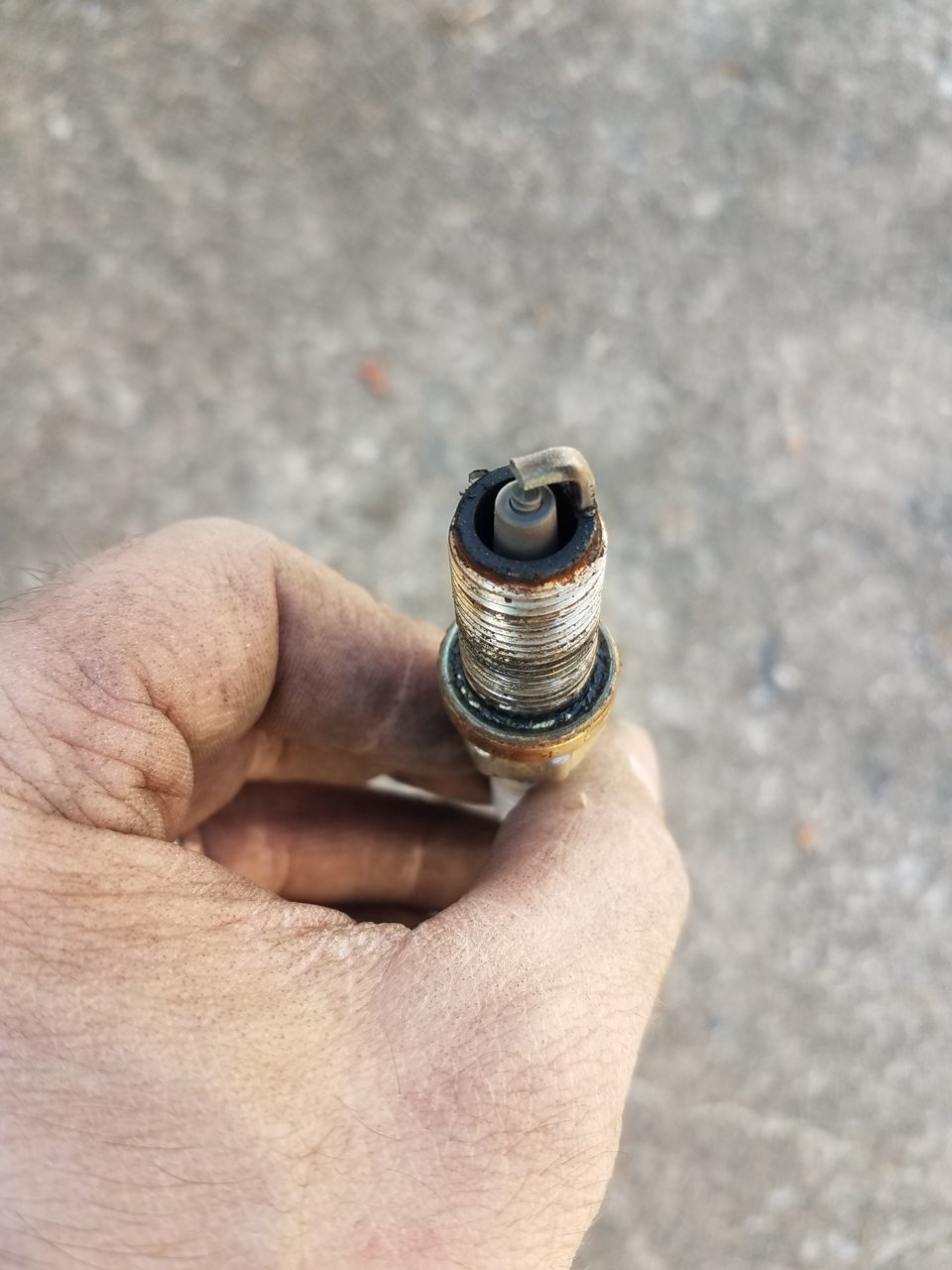

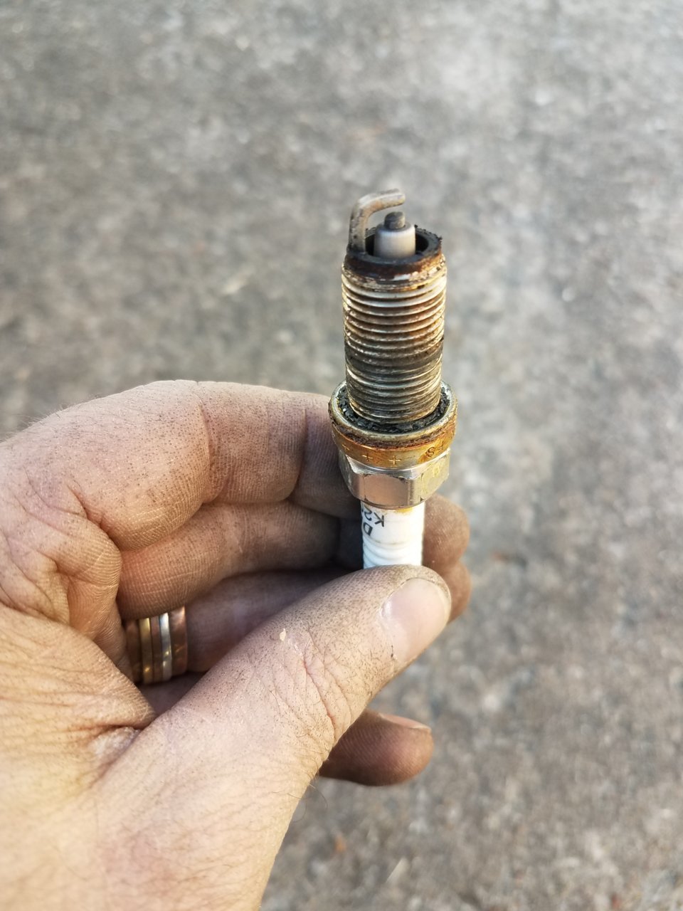

    I changed my spark plugs yesterday and they seemed to have a lot of gunk built up on the threads and around the crush washer. Is this normal? I don't remember what they looked like last time I changed them. Also the 15ft lb of torque that toyota recommends on spark plugs scared me a little bit seemed to tight to me20201128_113115.jpg 20201128_113052.jpg 20201128_113035.jpg

    Any idea how many miles are on those plugs? That's a huge part of gauging what they should look like. They are a little dirty but the electrodes look pretty good.
    I would say not to worry about them looking like that if they were changed when they were supposed to be but it's odd that the 3rd one is cleaner. May be some oil blowby on the top two. Does it use oil? Have you changed/checked PCV valve?

    They have around 30,000 on them

    It don't really use any oil. Not sure what pcv valve is i will Google it

    Positive Crankshaft Ventilation Valve ensures you don't get positive pressure in the crank case. In extreme situations positive pressure can cause oil to blow by seals and rings. Honestly it's a long shot for any issue you may be having but it's a cheap, generally easy to change part that a lot of people overlook.
    If mine looked like that at 30k and it's not using oil I probably wouldn't worry about it too much. Maybe run a cleaner additive in the fuel just to be safe.

    Alright thanks for the info. It's been running fine no issues but I will check it and run a cleaner. Do you torque your plugs to the 15 ft lb?

    I do. If you don't use enough torque the crush washer may not crush.
    Also use antisieze. Buddy who works for a major parts retailer said a manufacturer rep tried to tell him you don't need antiseize for their brand. Doubt the manufacturer rep would come by the house and help me remove a seized plug though so...

    Alright I did torque them but I was feeling a little uneasy about it seemed pretty tight to me for aluminum
